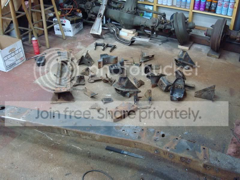

BTW -> I just removed a bunch of body mount bracketry recently (and crossmembers) it's not that hard with a cutoff wheel, hammer and punch but it IS tedious....
Here's your 1000 words:
