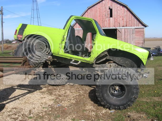

cheap fenderliners..
The bedliner would probably work..(too bad your not closer-I'd pay 20 buck for it for my C10! :doah: :( )..
I'e seen guys use those roll up kids toboggans as fender liners on new trucks to keep salt from building up and rotting out the fenders and cab..they are just a sheet of polyurethane plastic,flexible but stiff enough to hold its shape..I think the ones J.C. Whitney sells look like the same material,only vacuum formed to fit like a glove on a particular truck.. :crazy:
i used the old bed mat out of a nissan p/u that i scraped years ago. work better than not having anything, stopped more than i thoght it would :D
and it still says nissan :haha:
lol, bummer. The liner has a couple of holes and cracks (like golf ball size) in it from previous owner abuse... so it aint worth much at all as a bed liner. It'd be easier to cut/notch than flaps if I need to make room for shock towers or whatever in it... and its plenty long enough that I could make them cover pretty much everything from firewall to the electric fans.
