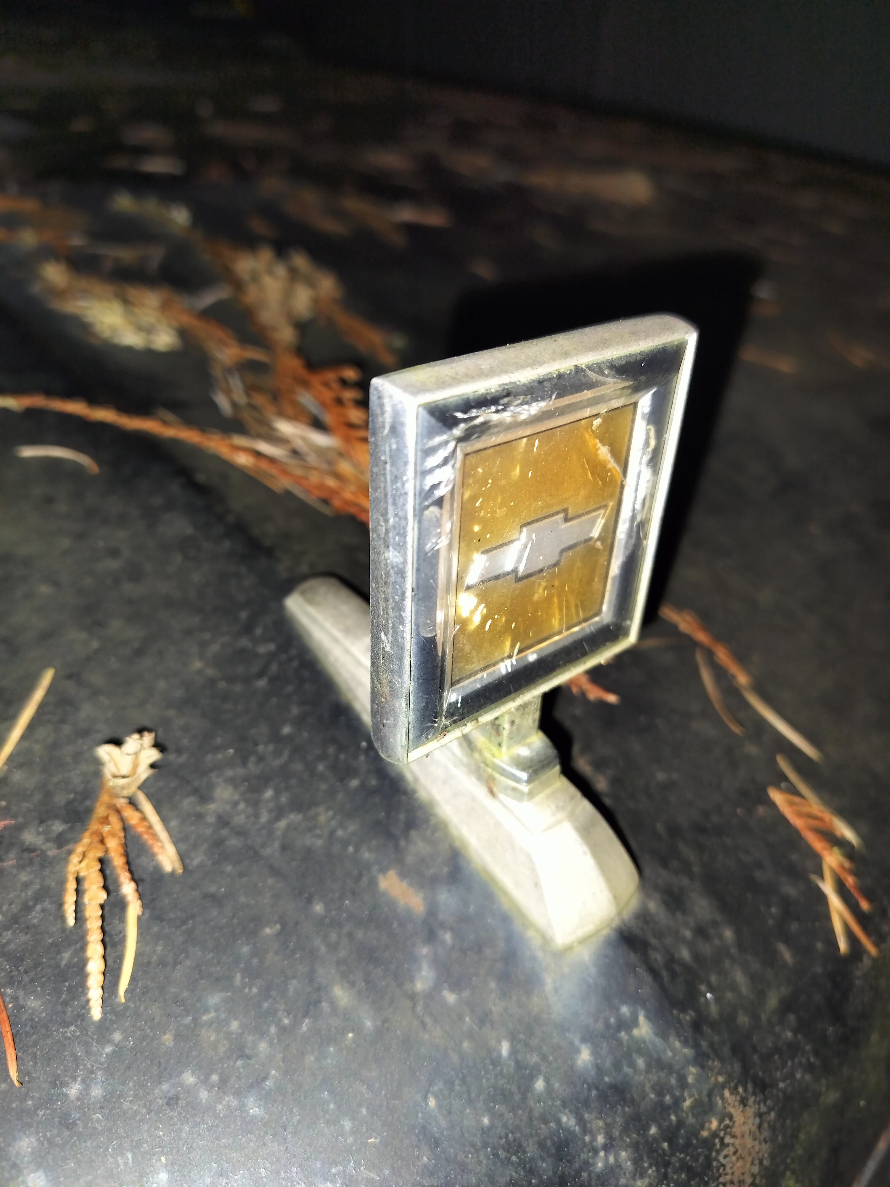

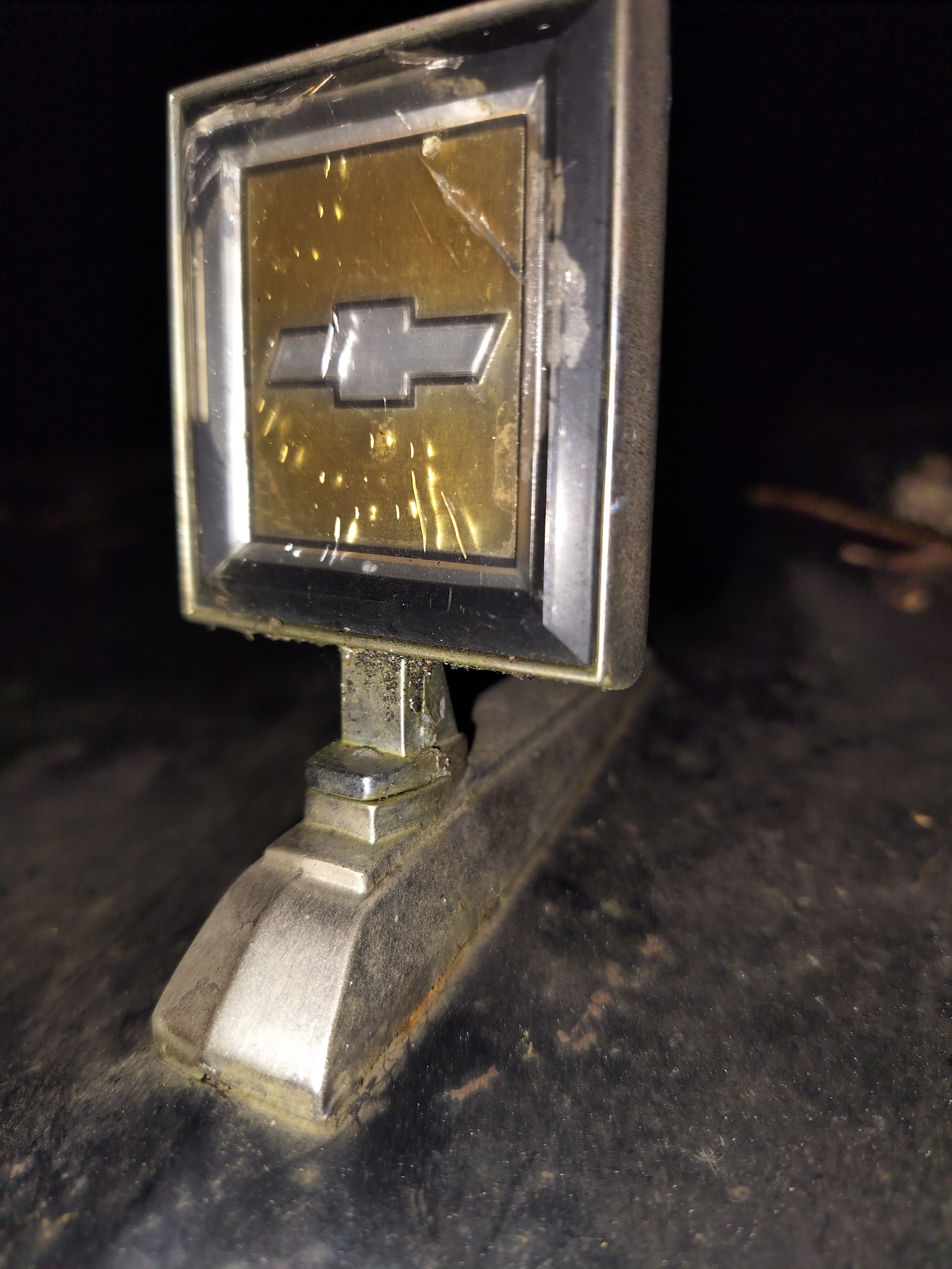

I need dimensions for the base of the hood ornament. Length, width, height. Want to print it so I can get my hood ornament mounted. Thank you in advance.
Legen-dary.Length against the hood is 3.345" at the hood ridge
Length against the hood at the extreme edges ~3.25"
Length along the top edge (above the "step") is 2.766". That is point to point as both ends are angled (the longest length)
Length along the top edge corner to corner (shortest length) ~2.67"
Front height below the "step" is .430"
Front height at the ridge is ~.613" (had to eyeball it)
Rear height below the step at the hood ridge is .067"
Rear height on the side, below the step, is .140"
The "stepped" portion is .10" tall
The "step" is .59" wide
Pedestal for the ornament is .119" at the front, blending into the overall height at the trailing edge of the ornament

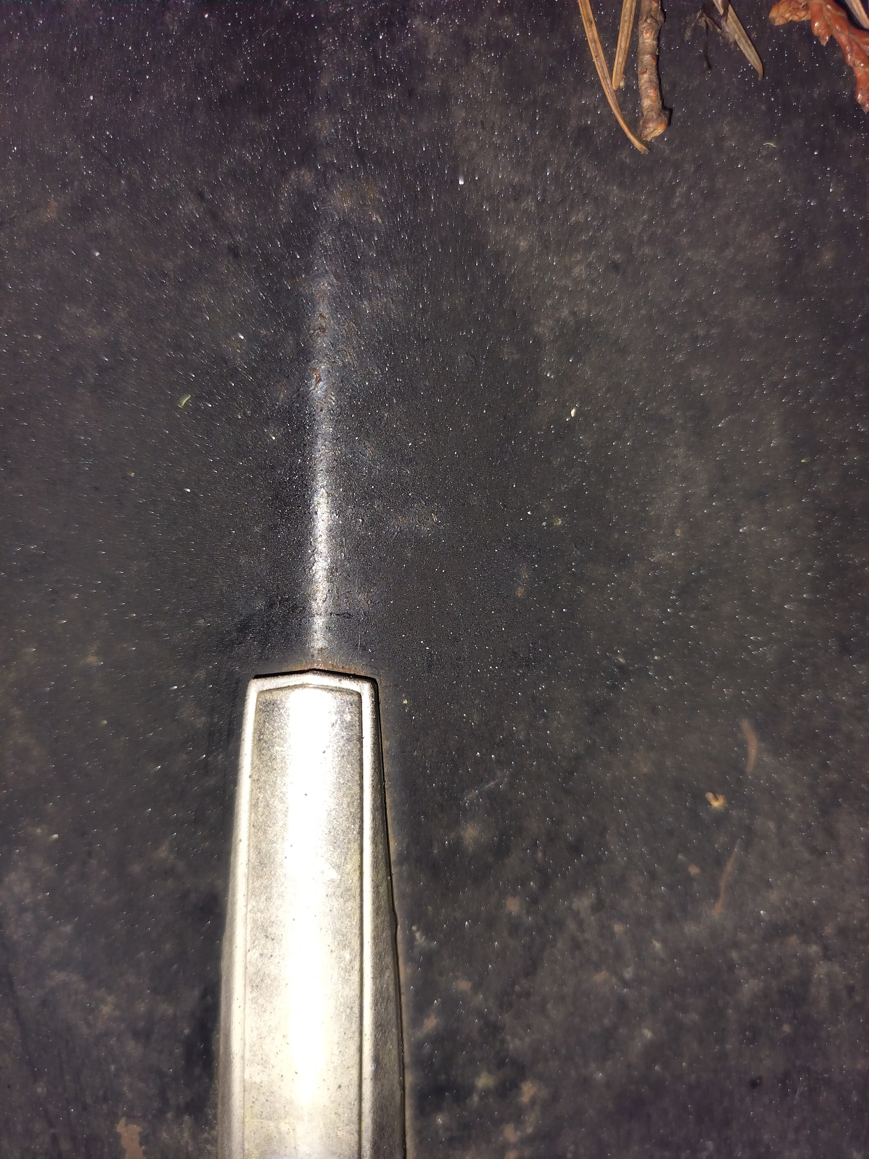

Base width front edge is .804" before it rounds
Base width rear edge is .494"
I'll get some better pics to help associate the dimensions with the actual piece
If mine hits something, bigger issues are at hand.Keep in mind those OEM hood ornaments are spring-loaded to avoid breakage if hit or bumped up against.
