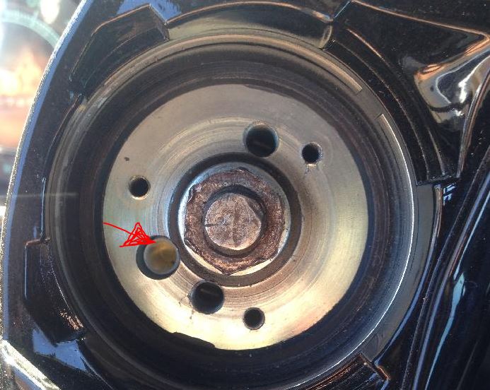

I ordered the "Horn Contact Kit" and it arrived today. I'm not sure where or how this is suppose to ground my horn??
Where does it go and in what order? I'm guessing the larger hole with the plastic sleeve? I'm confused again. What happens if I remove the nut? I'm guess in there should be at least a black wire in there for the ground? Is it a pain in the ass to put the steering wheel back on me?
No wire in mine that I could see. The metal pin contacts the brass at the bottom of the hole. The red arrow points to where the parts go:
It is the metal plate that is pushing it down, so the circuit is completed by the pin contacting the bottom and the top when pressed down. The spring pushes it back up.
So order of dropping it down the hole is spring first, then pin with plastic part on it.

Makes some sense now. Spring first, then the pin with plastic sleeve on it. I'm guessing the flat head goes in first against the spring?
