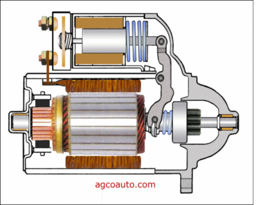

But it's not always going to work. It creates a race condition where the starter can spin before the gear is engaged and prevent it from meshing with the flexplate. That method is for the Ford-style starter where the spinning of the motor extends the bendix, not the Chevy style where the solenoid throws it out.

yep motor doesn't turn till drive is extended. I am still missing the part where drive will spin before engaging the flex/fly wheel
Oh, your purple jumper wire is between the S and the B. Then the timing will be correct. However, the voltage will be reduced since it's passing through both sets of contacts.
