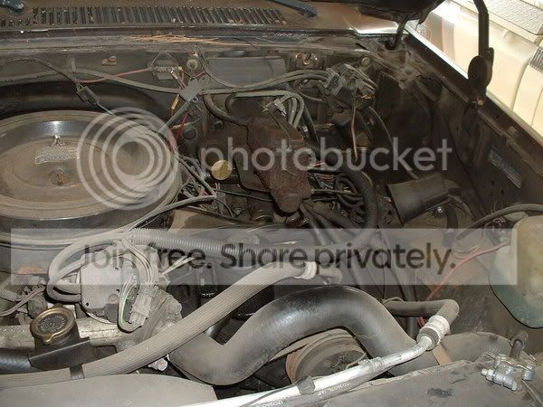

Can you see the solonoid in this pic here.. or the general area..

Your glow plug relay is right behind the windsheild washer fliud tank in your picture..there is 2 small wires on the top of it in a plug...without disconnecting them,take a wire from a good ground,and touch it to the light blue wire on the top,its the closest one to the firewall out of the two...that should "energize" the relay,and start the glowplugs heating cycle--
DONT leave them on TOO long or you will either burn them up,or cause them to swell up,and be difficult or impossible to remove later!..no longer than 15 seconds at maximum...you might need 2 people,or to hook a remote pushbutton to the "S" terminal on the starter and to battery positive to get it started,since its impossible to be standing near the relay,and jumping the solenoid at the same time.
( I reccomnd using the remote pushbutton,use alligator clips to attach the wires to the solenoid and battery cable--its dangerous being under the truck to start it!...)
If you cant hear the relay "click" when you touch the ground wire to the blue one,then your "main power source" wire might have been cut--it comes from the starter solenoid,(where the positive battery cable bolts to the solenoid)--runs behind the motor,and goes to a plastic "junction" block next to the master cylinder on the firewall--you can use a jumper cable from the stud on that junction block to the battery positive terminal,to give power to the rest of the trucks electrical system....then the relay should work,and you can start it by energizing the glow plugs,and jumping the starter solenoid..

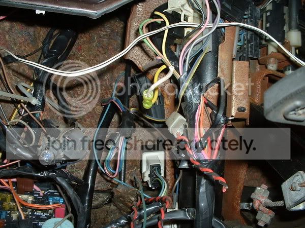

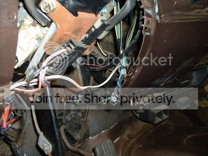

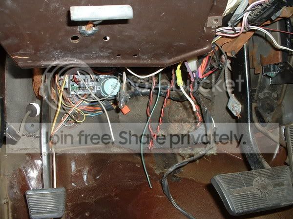

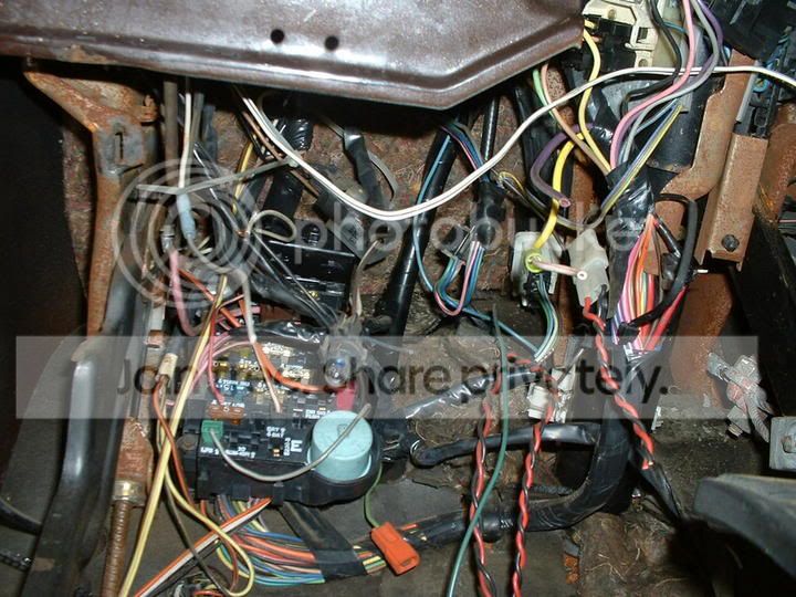

I havn't had a chance to try to start it yet.. but I got some wires to use to jump it and I took some pictures of my wiring where the alarm and stereo were stolen..
You probably can't make any sense of this.. but I thought I would give it a shot anyway..
Butchers!!
Yes,they did cut quite a few wires,huh??...I see in the next to the last picture they cut the thick purple wire from your ignition,which is the one that makes the solenoid start cranking when you turn the key to "start"--it looks like they cut it just before the neutral safety switch,which is located at the bottom of the steering colum..it goes thru that switch,then out to the starter solenoid..
Good luck!--looks like your going to need some! :eek1: :crazy:

You can hotwire away!..I was just commenting on how many wires were cut--that purple wire ,if reconnected,might allow it to crank over by the key,if nothing else was cut!..
But for now,I'd just hotwire it the way I described!--once you get it running,you can worry more about getting all the original wires hooked back up!..GET TO WORK!! :deal: :rotfl: :rotfl: :haha: :crazy:

I just went down there.. i don't see how you get to the S terminal on the starter.. i can't even see thestarter solenoid from anywhere on the vehicle hardly..
I put a test light on the blue wire of the glow plug relay and it is getting power..
I can't find the fuel shut-off switch wih the pink and peach wire though.. where is that located?
