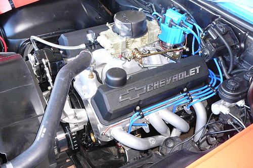

I have mine going under the headers but I need to have them sleeved as they're still getting burnt. Looks nice and clean though :)
