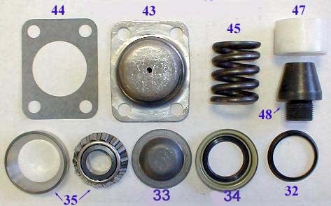

am i uneducated? school me on what a kingpin is. pretty sure my 44 doesn't have them. dana 60's right?
your d44 doesn't have them. a kingpin is what the good d60f's use instead of a balljoint. go over to pirate & read bill vista's d60 bible http://www.pirate4x4.com/tech/billavista/60_front/index.html if u want to see pics. king pin info is close to the bottom on the first page.
