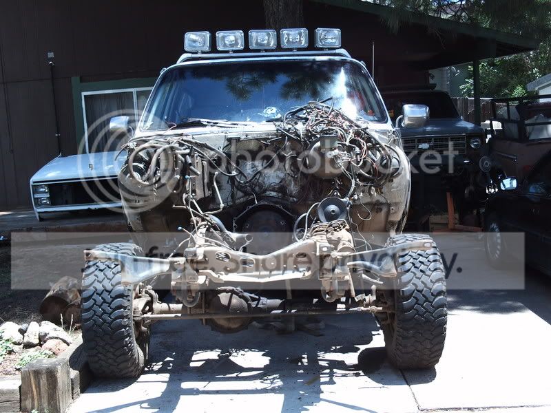

I've taken the front clips of trucks off to do it, not really that bad and it makes it easier in the long run. Your idea about taking the lowing the pressure is a good idea assuming it gets it low enough.

If its lifted really high, you'll have to remove the front clip.

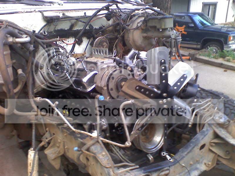

I just did this a little over a month ago. Front clip is not that bad. We got it off in like an hour and a half, allows access to everything you need. I hadn't done it this way before, but man did it make life easier

lower your tire pressure and take the front end off. it took me about 15 min. by myself
