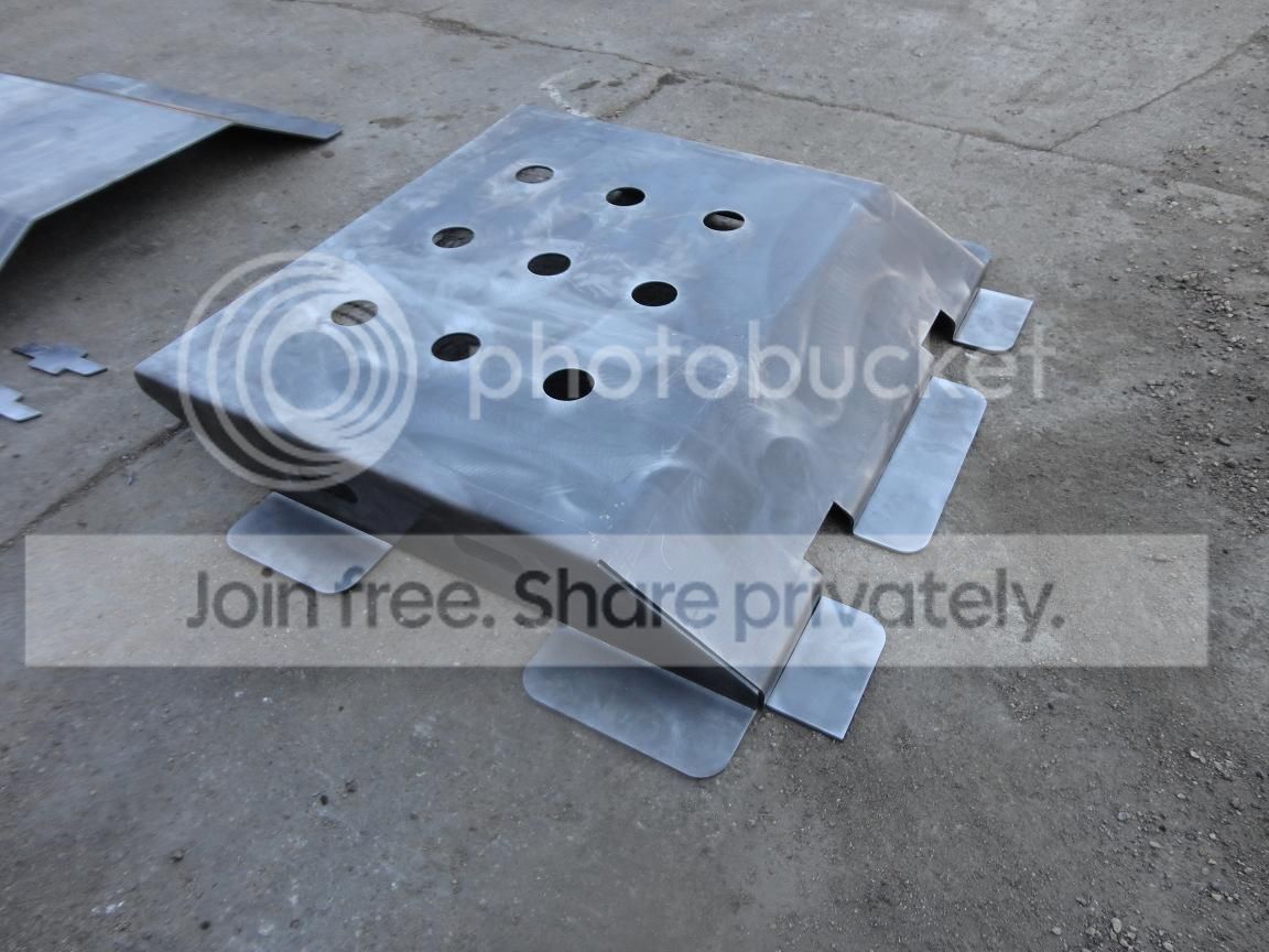

Recently, my gas tank skid plate took a beating. No I'm not going to cut a hole in the floor to move it up, I still want use of my bed.
Just wondering if we can get a picture or description thread going of how you guys protect the gas tanks on blazer (mostly) and other rigs.
:ears:
My Blazin Offroad rear bumper has a small "spoon" to help, but doesn't do much. Thinking of running some tube from the bumper to where the gas tank front straps mount. Make it all removable. Something like that. Or just bend some steel to hug the tank skid and screw them together. I save some ground clearance and gain 1/4" of steel protection.

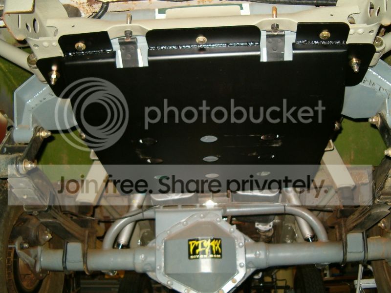

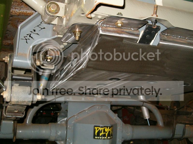

Thumbs up on the cool tank protecting plate above!

I am definitely doing something like that DIY unit above, but probably just added to the factory skid plate.

That's a very nice skid, I emailed Kert a while back about adding skids to his product line.
