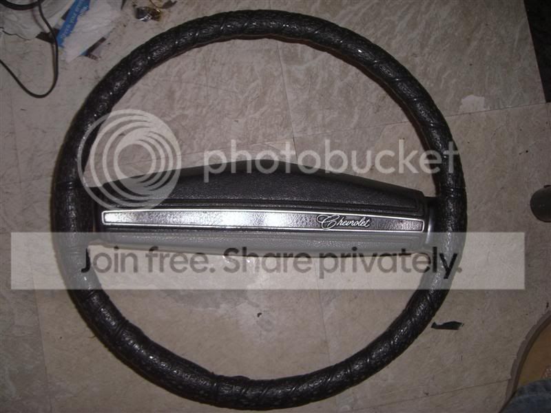

My steering wheel hub is cracked, so i decided to get a replacement wheel. I wound up getting one off a '71 Chevelle. How can I adapt the horn spring to let the horn work with this wheel?

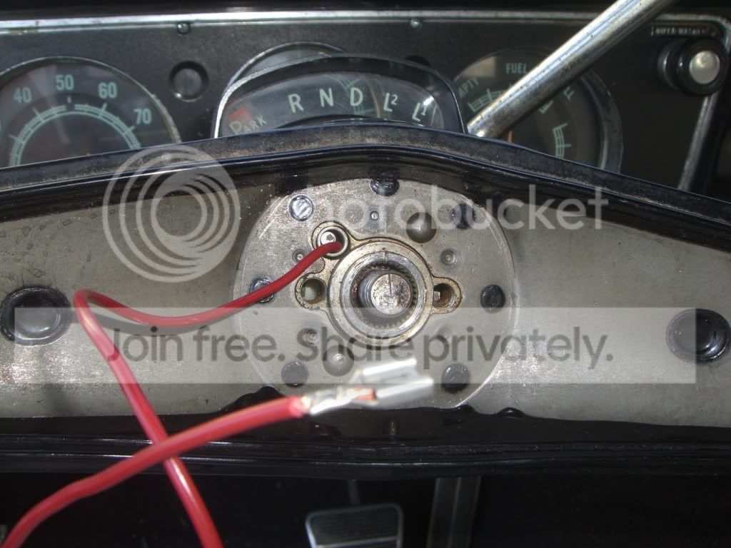

But, both systems ground the horn wire to make it blow, so if there is a way to hook that wire to the spade connector in your pic., it should work as long as the body of the wheel is grounded.

That wheel is so awful... :doah:
Sorry, I'm sure everyone was trying to be nice and just keep quiet about it in the hopes that you'd find a different one to use.

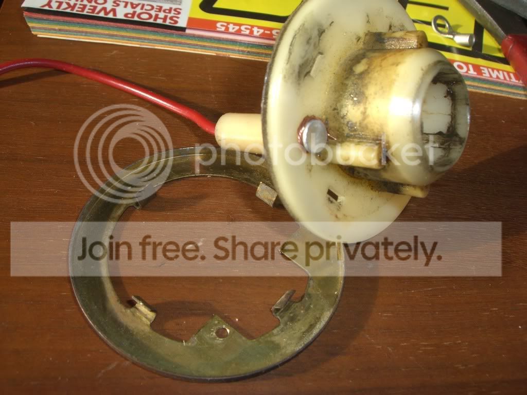

Thanks, you are right, it is a misleading title. The dilemma for me is how to get a spring loaded plunger style post to connect to a spade terminal. I cant figure a mod to get it to work.
Oh, I thought you had a problem...........
Try grabbing the post, and pulling up. There should be a wire under there hooked to the brass center of that post.
Most trucks have enough slack to pull out the wire a little. If not, you may be able to cut a wire tie or something at the bottom of the shaft.
Cut the post off, attach a short extension to that wire with a spade connector on the end.
I would remove the brass end piece from the post, and put the post back in the hole around the wire with a little glue, to act as an insulator.
You don't want that wire rubbing on the edge of that metal hole.

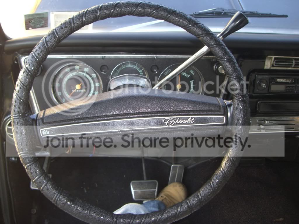

Well, after wasting a couple of hours staring at this thing, the beer fog wore off, and i rigged it up temporarily until brother Smitty sends me a piece.
I know alot of you guys dont like this wheel, but it only cost me $40 at a swap meet and there are no cracks, and the smaller diameter makes it have greater clearance to work under the dash.

I fixed it for good, with the help of a brother on another forum who sent me the wire i was looking for. I finally have a nice functioning steering wheel horn.
I put a mid 90s steering wheel in my 67' I just used a male bullet style crimp connector and shoved it into that little tube, Works great.
