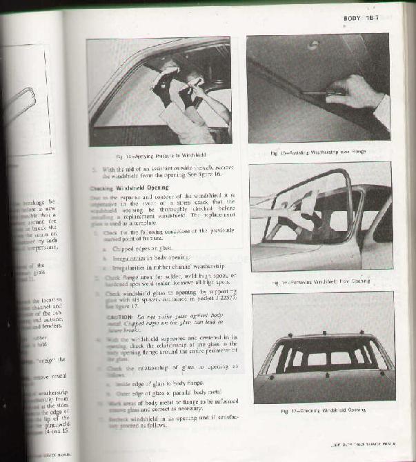

Here's an except from my 1973 service manual. I don't think this is OSHA approved for the tech's anymore...
The procedure just says to apply light pressure with your feet (make sure to put those rags on the bottom of your shoe), then take a screwdrive and work your way around. Excellent procedure!
I second Heavy Metal. It's easy as pie. I just did it a couple of weeks ago and it went easy. The glass I was removing was already cracked and it didn't get any worse.
There is no reason to cut the rubber gasket as the glass can be removed and replaced with the gasket on the truck. A second set of hands on the outside while you apply steady pressure on the inside corner is the best way to go. I used a couple of butter knives but as mentioned using metal is risky.
