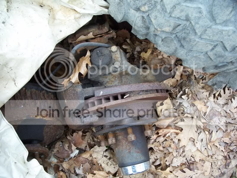

this is a srw hub. on a drw hub, the wheel mounting flange it out towards the lock in hub.
