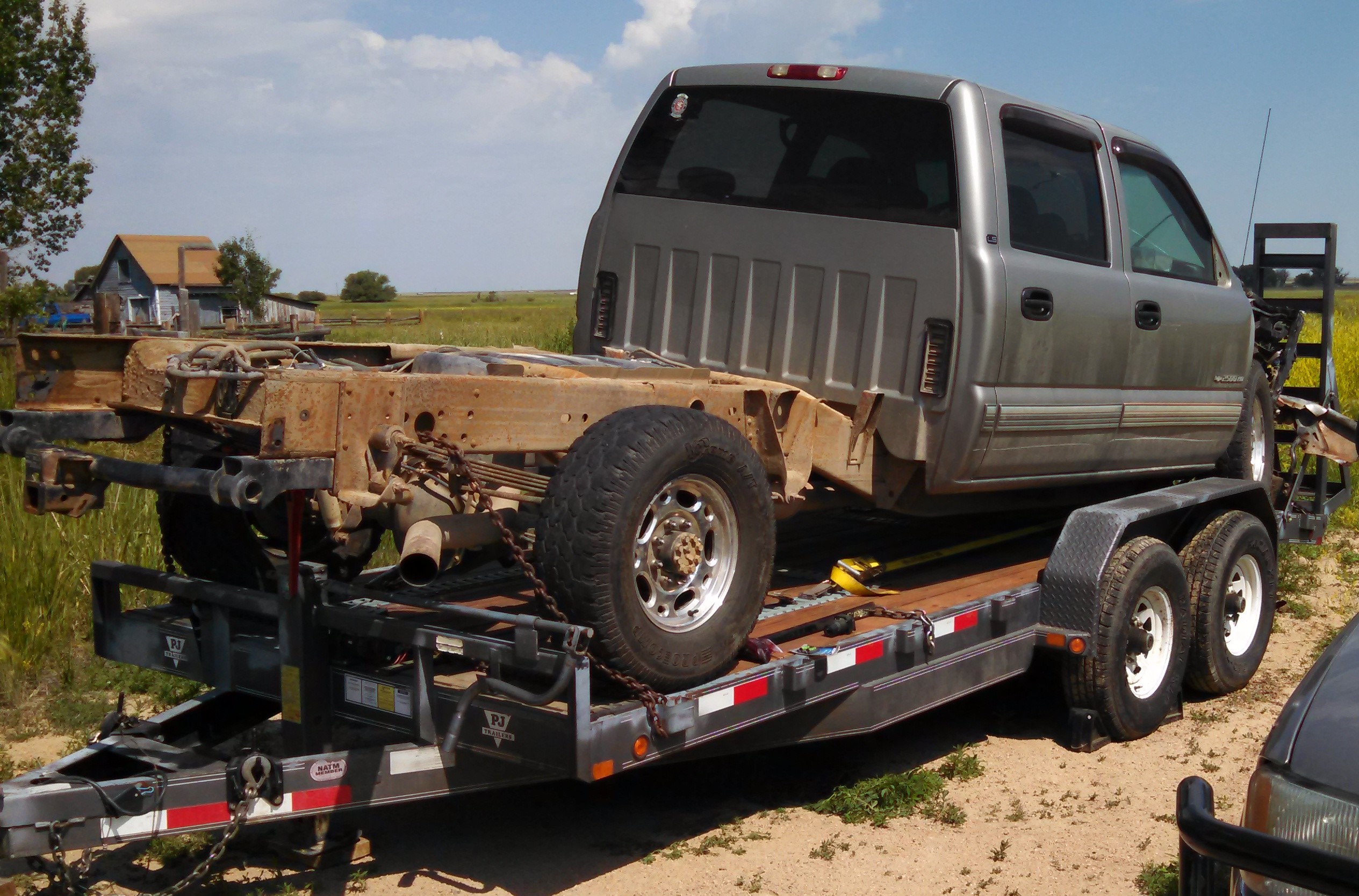

If we're gonna revive this thread, might as well do it right. Here are my 8.1 observations.
I have towed a bit with my Avy 2500, from Wyoming to Arkansas, in Montana, and a few trips in between Colorado and Wyoming. The heaviest I towed was 18800 lbs which is right at the GCWR for an Avalanche 2500 (with 4.10 gears; ones with 3.73 gears only have a GCWR of 17000 lbs). With that load, I towed from Arkansas to Wyoming, climbing up to 8100 ft at the highest, with several climbs and descents in elevation in-between. My fuel economy for that haul was around 6 MPG. It held 55-60 on the steepest part, pedal to the floor. If I had the lower gears, I think it would have done even better.
GCWR: 16,270 lbs
