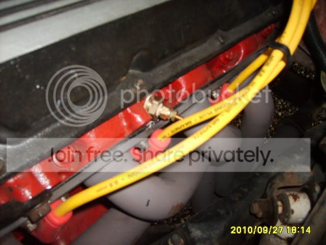

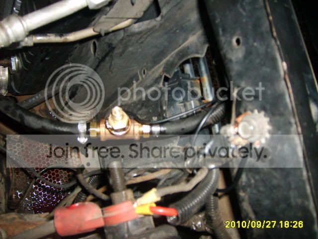

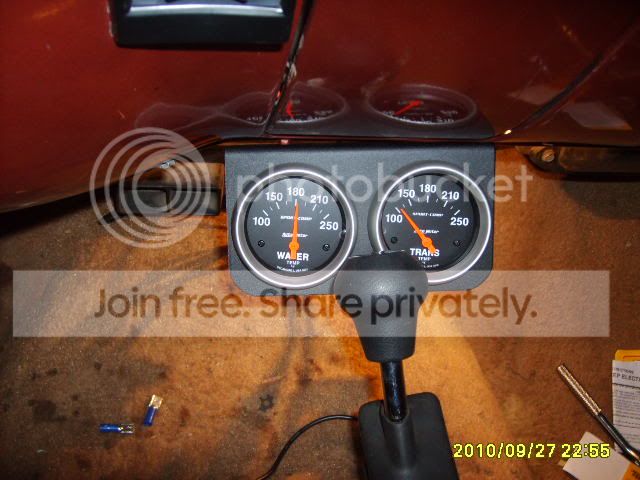

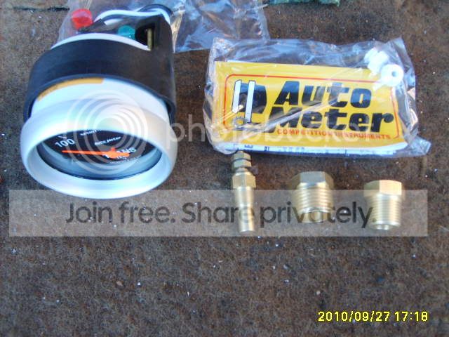

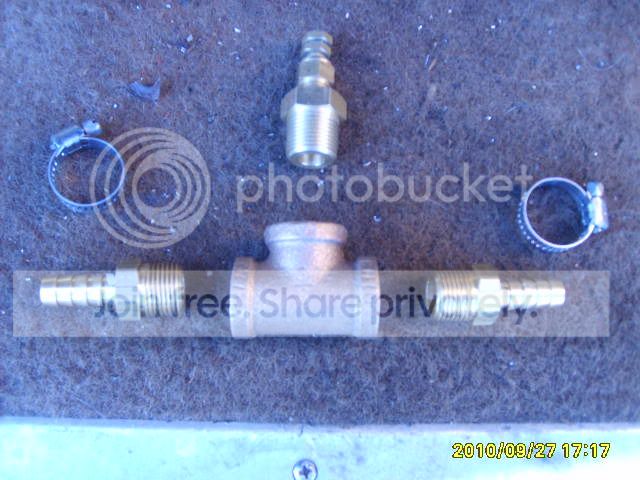

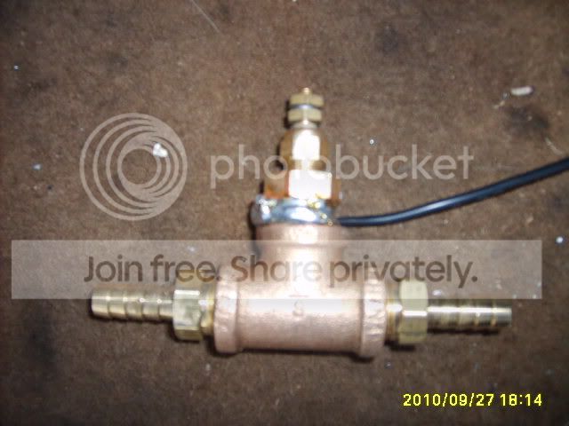

well it seems to work flow or not, it got up to about 205 the I filled it up, put thecap on and unkinked the heater hose and went back to look and it was down to 185?? Here are the pics of the quick install of the two temp gauges. Gonna put them in the dash when I get the rest of my gauges.
Had to put together an adapter to make an in-line fitting for the trans guage. used a 3/8 tee fitting and the adapter from autometer.
then solder on a ground wire since it wont have one otherwise.
the water temp sending unit installed
the tranny temp adapter installed and feeding into the auxillary cooler, this will give me the temp of the fluid coming out of the radiator.
and finally the guages in their temporary spot, seems ok despite the apparent flow issue

not that anyone ever wants to change their stuff because someone else said they should, but you really should be reading the trans temp before it hits the radiator. My sensor will be in the pan.
Reading the temp after the radiator (return line) would be the same as in the pan. The fluid leaves the trans going to the radiator and/or cooler , then back in to the pan. You trans readings would be very high if you were taking the reading from the pressure line.
Reading the temp in the return line will bo cooler than reading it in the pan. The reading should be taken where the most fluid is located and not rushing past a sender.
