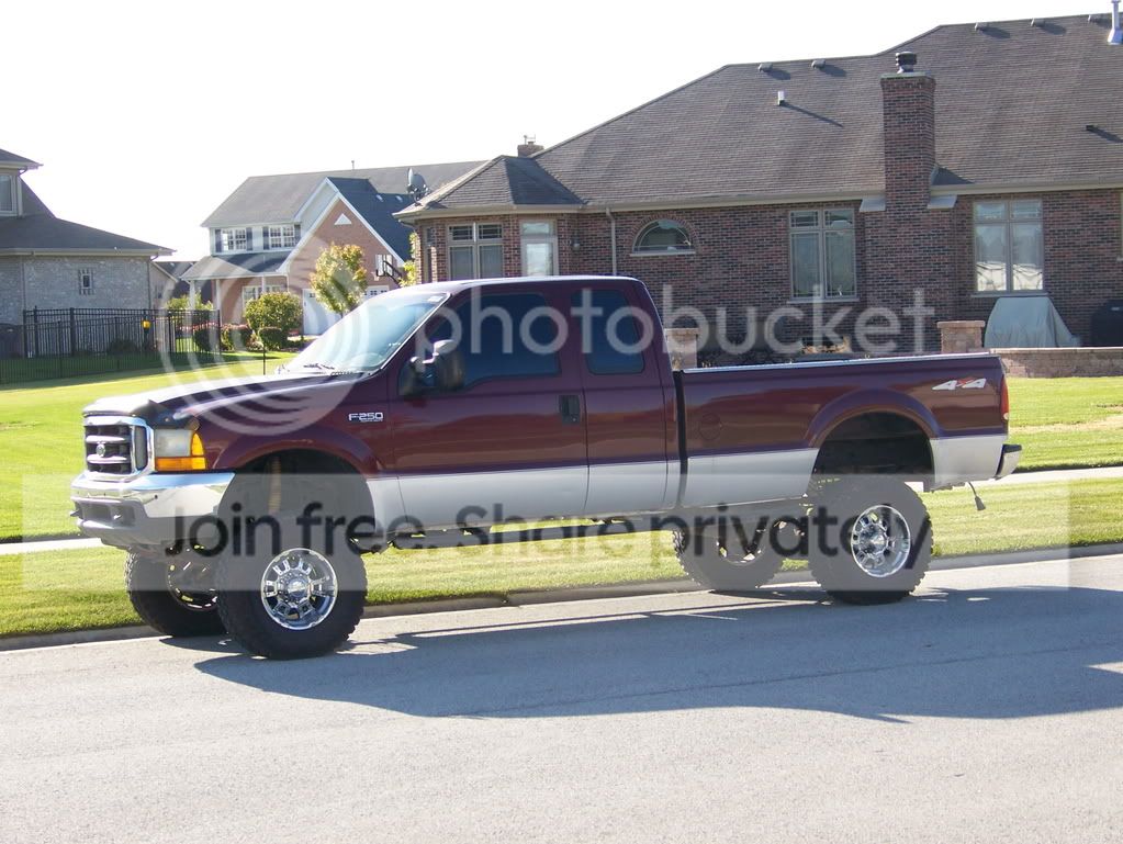

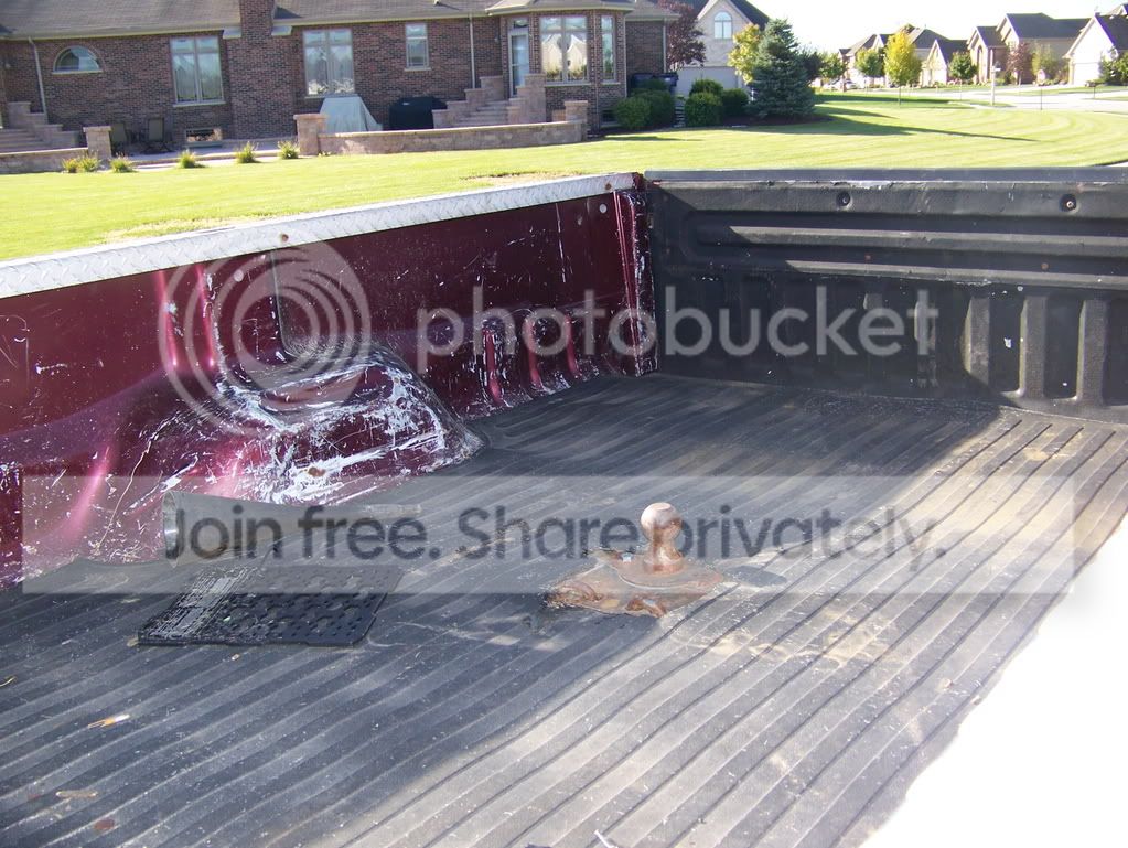

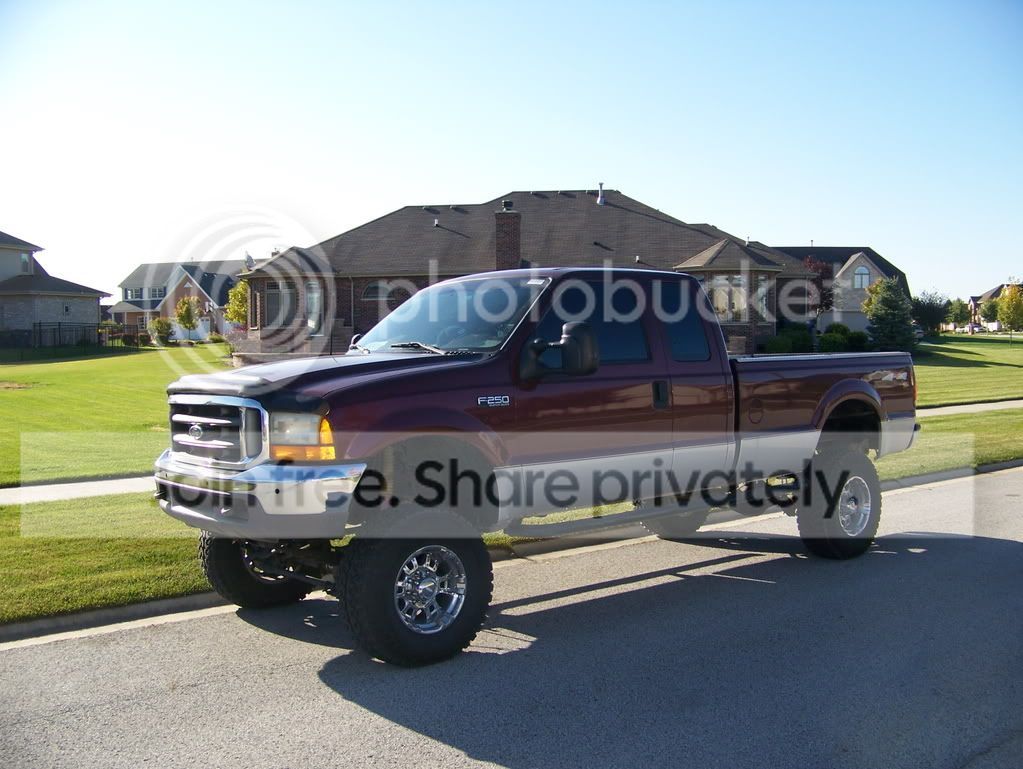

There's a guy in S.A. with a shop that specializes in diesel performance (N.E. I think) who has a lifted Super Duty and pulls a 24 foot gooseneck car hauler. He came up and got a truck from me, and I gotta say, I was impressed with his setup, it was done right, and handled well.

What Size lift , and tires was he running. On my 99 F250 I have a 5.5" and 35's. I am kinda worried about tongue height with a goose. I really don't want to lower it either.
A 7 inch lift on a 2500 HD is as high as you can go and still be able to tow a gooseneck. I know several people with this exact lift and its also recommended as the highest lift to be used by several installers as well.
Another point to consider is if you adjust the gooseneck down to level the trailer you will soon have clearance issues between the gooseneck frame and the bed sides.
