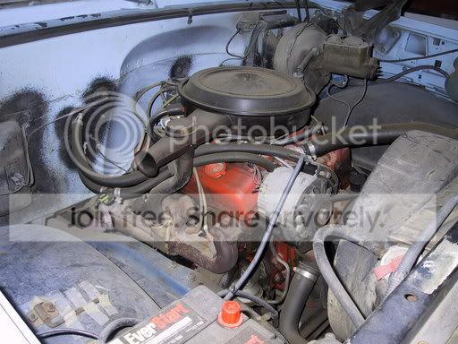

OK, here are the pics. All of the pics are of the blue one (Rusty) except for the red/white one (Butch). Tell me what you guys think. After looking at it last night, I think Rusty is in better shape than I originally thought.
Sorry the pic isn't better

Black smoke, no power etc etc sounds like tune-up and carb issues. The choke is probably sticky so it's running way too rich until it's completely warmed up.
The front end issues...probably feel worse than they are. I would still get under it and tighten up the steering box bolts and visibly check each 'link' in the steering system before driving it.
