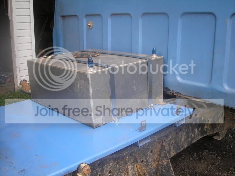

Here's mine.
I went with that size and material because the price was right.
