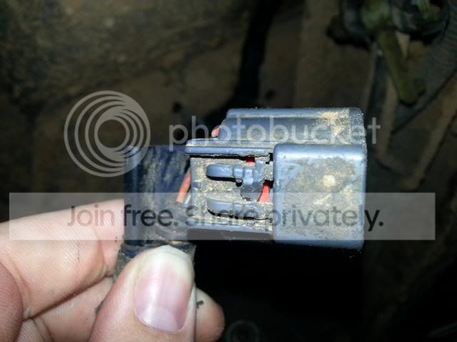

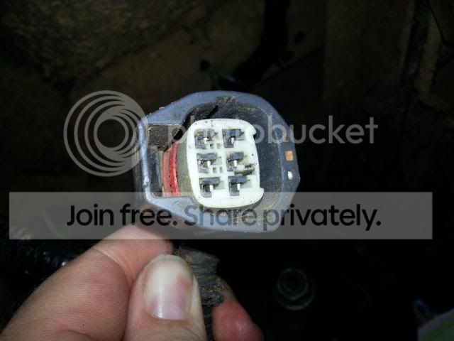

Well the wires got ripped off the transmission range sensor, and they said that's when the shifting problems started. They soldered the wires back on, but I can't tell if they got the pinout right and i can't find a wiring diagram or a testing procedure for the harness. 12 pin connector but only 11 are there, one of the slots is empty. :confused:

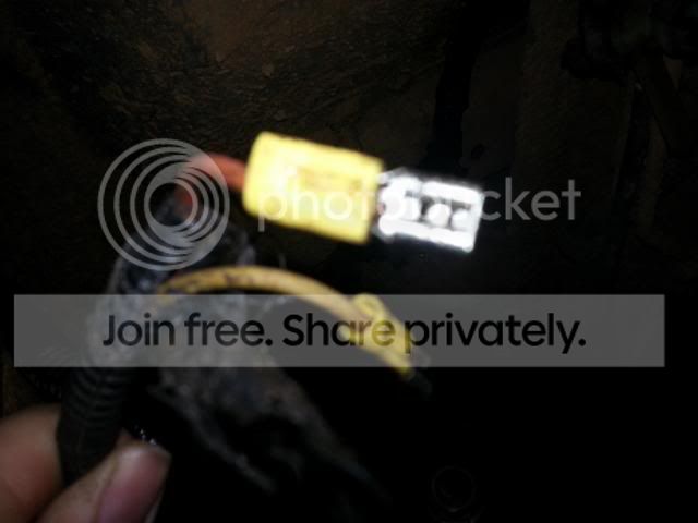

And there's a plug and a couple of other wires dangling.:doah:
Random wires with crimp on ends...
Loose plug, all of these are next to the trans/TC

After some digging, looks like the loose wires and plug go to the TC shift motor which is not there... not a big deal right now, not to worried about 4wd atm.
