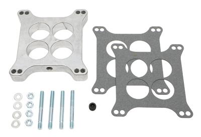

If you need another vac port, there are carb spacers setup for a vacuum bung thingy. I'll see if I can find you a link...
oh i see...ill look into that for sure...i have a 4160carb 750CFM dual feed fuel and im 90%positive i don't have another manifold vac. port, but i will look again, if i don't...then ill have to go with one of those spacers i geuss.
