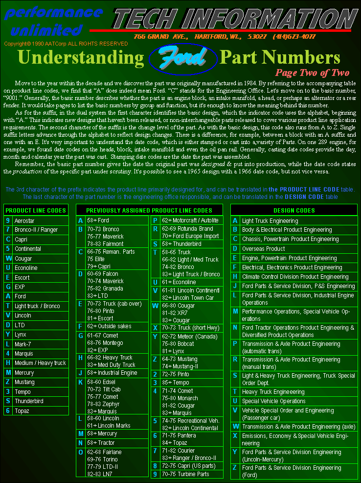

a little something for those of you looking into alternative power sources.
