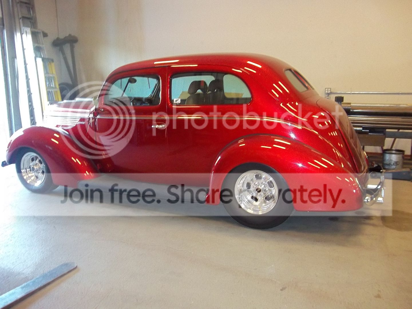

my bud just had this done last winter.. candy apple red, perfect...
25 g's.... almost 5 grand in materials... keep in mind too, bodywork/prep/paint will eat up as many hr's as you can throw at it....
I figure anything in the 3 to 5 range these days is fair for a quality paint job with a decent paint...
