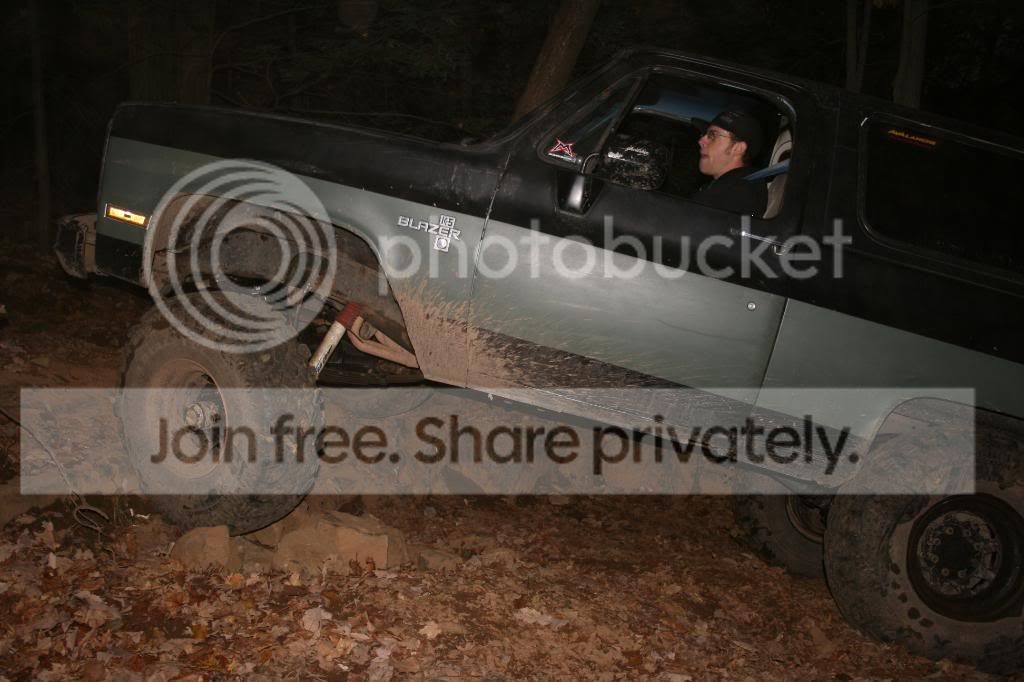

before cutting the front:
3" Tuff Country lift, 37" MT/R's and a little trim. They do rub just a bit when flexed but not bad enough to do anything about it.
Rather than going with a larger lift... I like the combo of ~4" lift and some trimming... for superior "vehicle dynamics" reasons IMO.

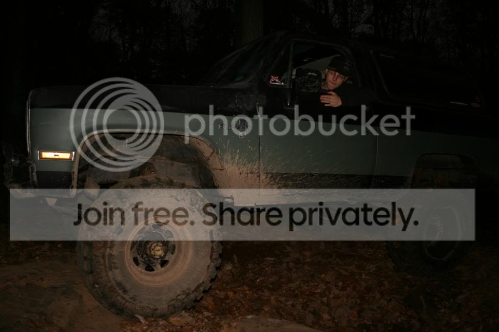

The way my truck used to be setup:
4" lift and 37" MT/R's, tires were far from the firewall. You definitely don't need to move the axle forward to clear anything less than 40's.

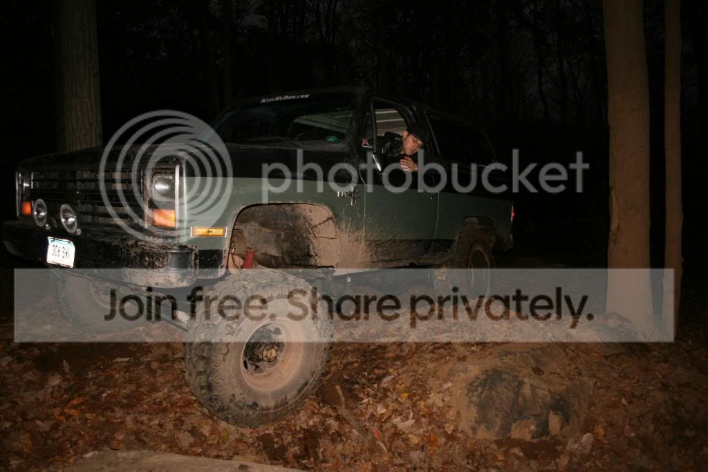

And one to show how the fenders are trimmed (they are actually cut up higher all across the fender too since they were rusty)
