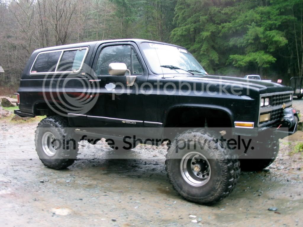

Here is my 75 with about 4"lift and 37's. Took this pic on my wedding day. had some time to kill. hope it helps

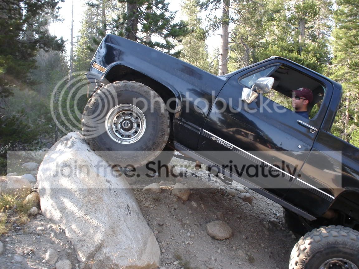

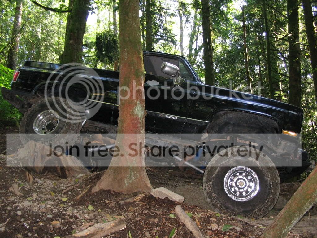

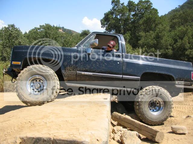

Here is mine with 4" lift springs and 37's
With 52's I had to cut a bit more because of the travel.
There are a bunch of pics in my build thread.
