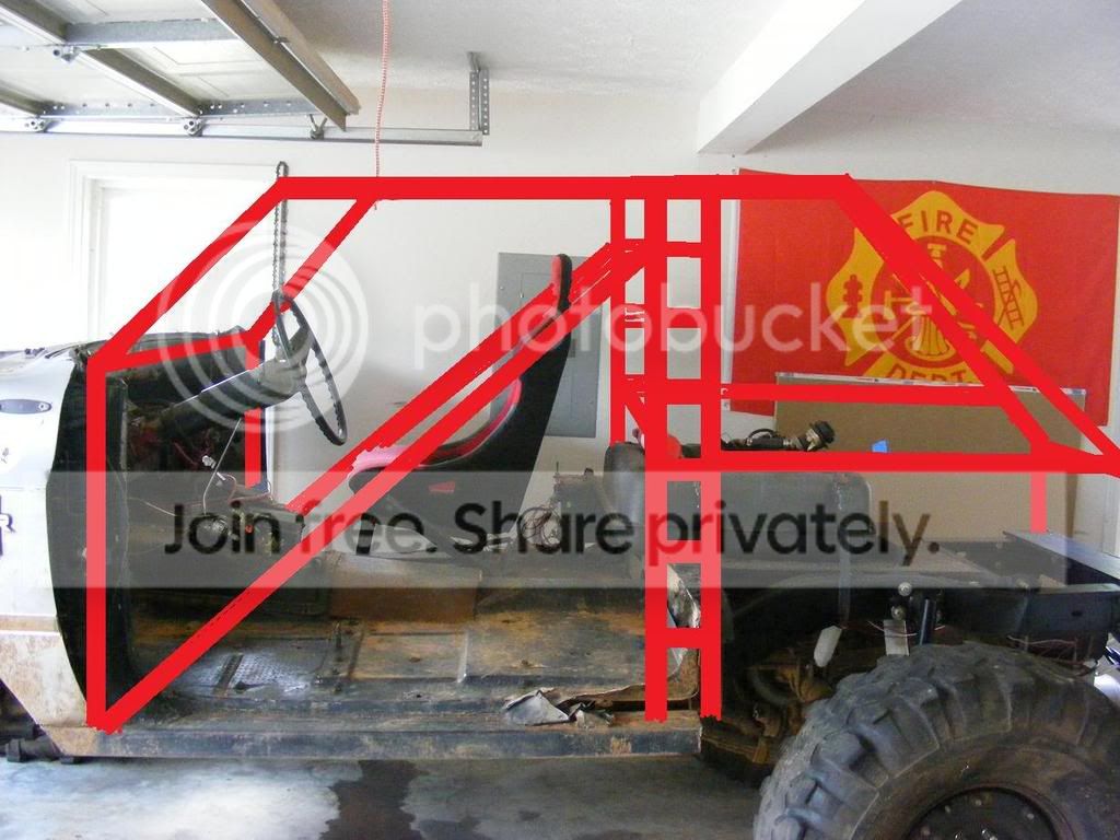

Hey guys, its that time. For all of you that have already done the cage, how much tube did you use. I'm thinking in the 100-120 feet range. I like the cages with alot of tube work. Pics would be great too, if you got em. Here's my platform
Will the cage cover just the front two seats or will it cover the rear seats too?

front and rear, don't think I want enough room for pass in rear, just enough for gear. Thanks
Wow, rdn2blazer that look great, something along those lines, no pun, just with out it going all the way back. About how much do you have in the rear? Again very nice work

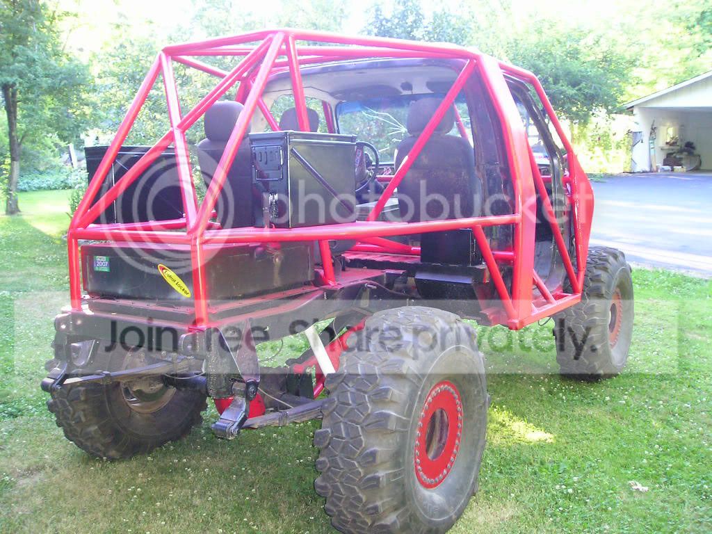

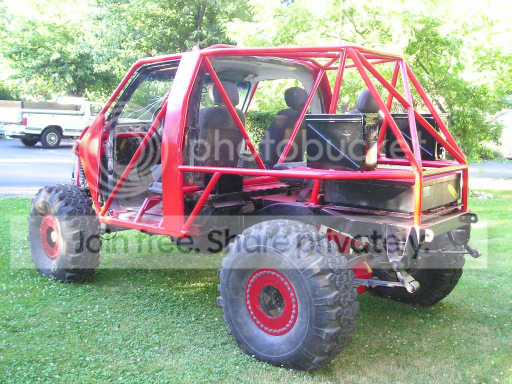

I have about 170' in mine. But, I wanted to cover the rear pass. area too. Not a great pic, but you get the idea. Seats are bolted to cage as well.
