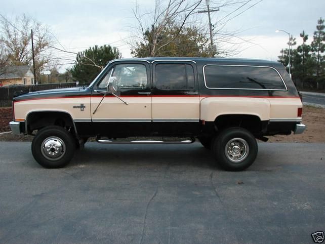

Dually Suburbans
Actually they DO list dually adapters for all 5 and 6 lug half tons in the old J.C. Whitney catalog I have,even for mini-trucks like Toyota's and Rangers,Vans too..the ad says to use "original steel rims " with no modification..
Well that was easy. How wide is the spacer if it allows for stock wagon wheels? :eek1:

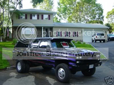

I think it would be neat looking to put dually rears on something never intended for them--like an SUV,or a car..turn some heads for sure..
One disadvantage to these adapters and fenders is you are likely to "forget" those fenders and tires are now sticking out a foot wider than your truck was before...might not fit in your garage door opening any more,or that narrow alleyway you use for a short cut!...get yourself in a real "jam"...:blush:
