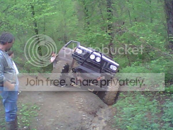

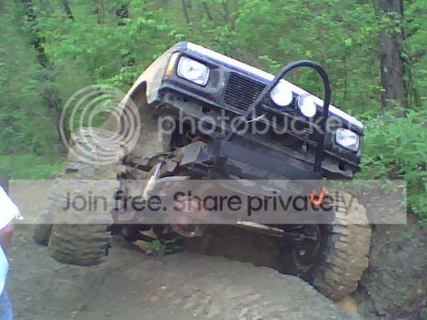

Would removing the sway bar help with the flex
yes removing the sway bar would get more flex. i would just recommend the quick disconnect and also look up the shock tower relocation on the tech article page
www.offroaddesign.com makes sway bar disconnects for these trucks. As said, relocating the shock tower will help. aftermarket,flexy leaf springs will help......and airing down the tires

Before you spend the money on disco's I would just unhook it from the axle and see how you like it. It looks like a trail only rig so I would just remove it and trash it. :D
Yes.But before ya go out and buy disconnects you should try unbolting it from the spring plates,swing it up and secure it to something,and take it for a spin.Like many other guys you may find you dont miss it at all and just toss it :D
And unless the shocks are your limmiting factor on compression or droop,the Ford shock tower mod will do nothing for you :D

I will trash the sway bar. Will longer shocks help? I have skylift 2 inch on the front. What about DIY kit B52 kit ? How hard is coil over switch? I have the rear end working great with teraflex . And it is my daily driver LoL Thank to all for the help
removed the sway bar and shocks. It was the shocks holding it up. It flex great now with new shocks and no sway bar. Thanks to all of you
