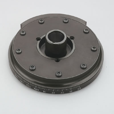

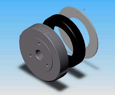

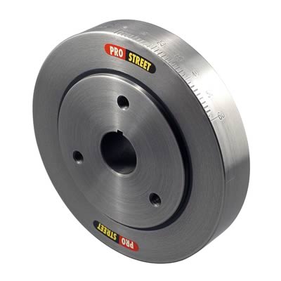

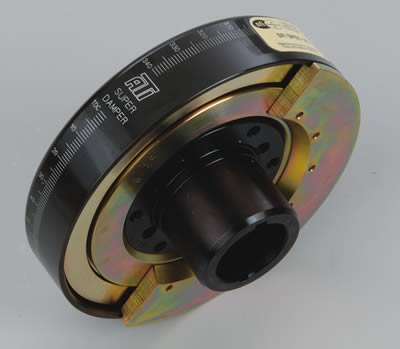

Probably the easiest way for the novice to determine if he has a 400 or not is to look at the harmonic dampner, which is what all of the crank pulleys bolt too.
Since the 400 is externally balanced, the dampner will have some material removed around one side to act as part of the crankshaft counterweight.
Here are a few pictures of harmonic dampners for externally balanced engines:

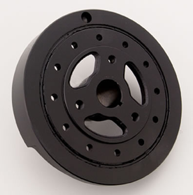

This is what a dampner looks like for an internally balanced engine:
