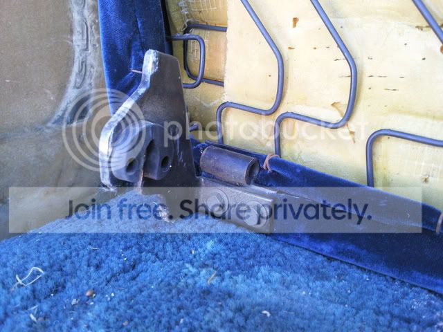

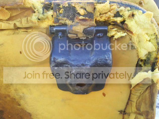

First. I had to note what had to be done. So I compared the brackets and found that the rear clip part is exactly the same. The front was the only problem. Upon inspection. I found that the suburban seat had the pivot mount for the brackets from the k5 seat.
Here is the front k5 seat mount.

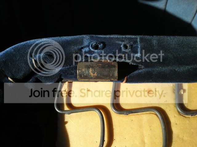

Here is the front suburban 3rd row seat mounts.

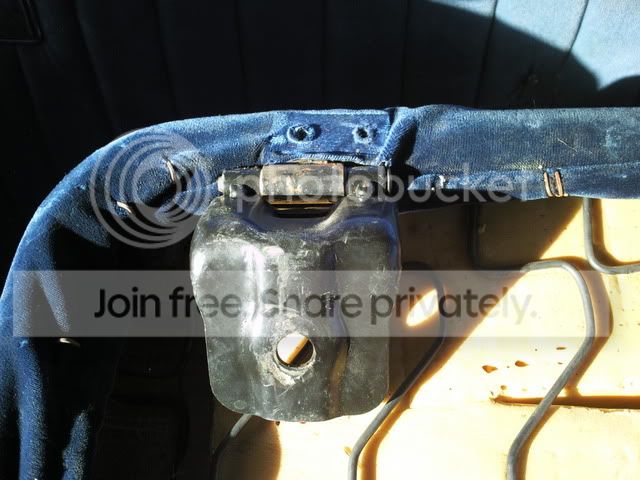

So I drove out the pins in the k5 brackets with a hammer and punch. Don't forget to take the little bushings in there also. Here is what you end up with.
i717.photobucket.com/albums/ww180/DurtySpeed/Photo0151.

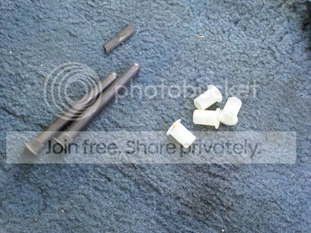

Then I unbolted the brackets from the front of the the burb seat to be left with this.

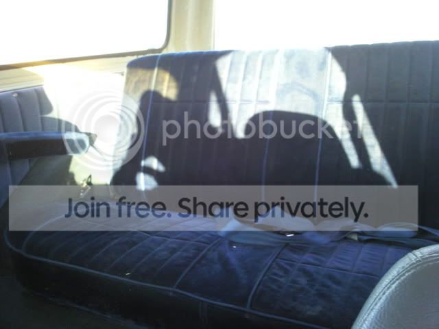

Then I inserted the bushings into the mounting point for the blazer brackets on the burb seat, lined up my brackets and hammered the pins in. It ends up looking like this.
i717.photobucket.com/albums/ww180/DurtySpeed/Photo0152.
Then I bolted the seats into the factory positions in the k5.

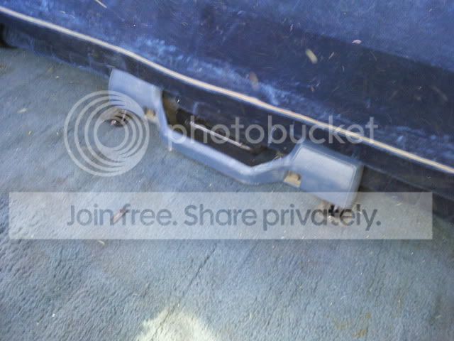

Here is the rear latch mechanism down.
