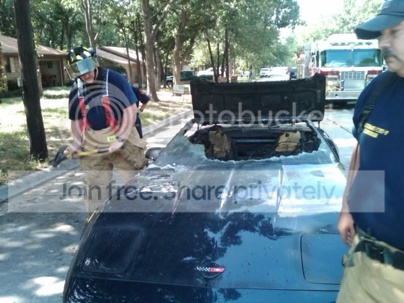

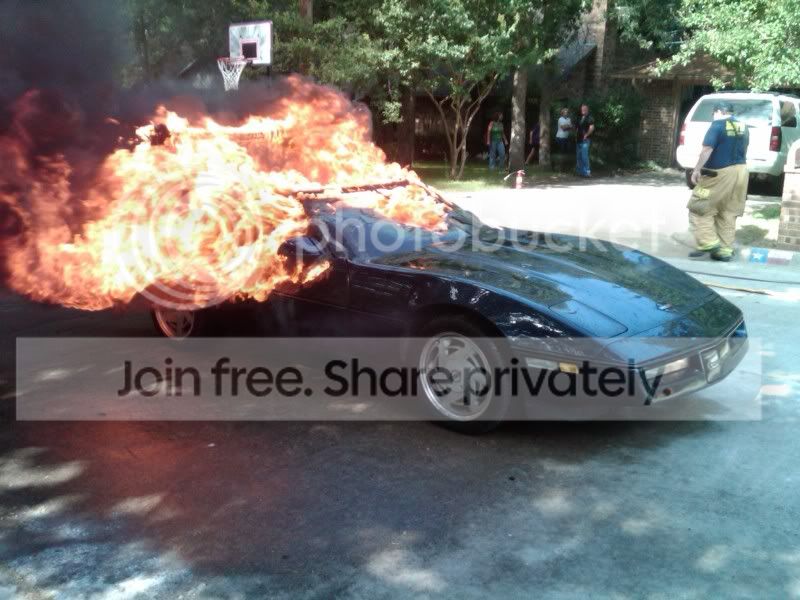

Reminds me of the time I couldn't get the hood on my Vette open.
First, just set it on fire:
After that, the nice fireman will insist on getting in there for you (despite the fact the cable has melted), any way he can (to disconnect the battery). (Not gonna lie, I know I had to be smirking when he broke his axe on the fiberglass hood).
