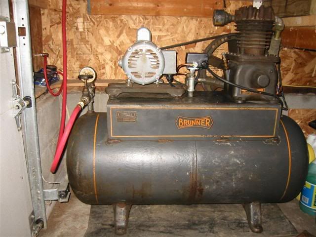

My current Brunner 30gal single stage compressor is good for removing/filling tires and general mechanic work, but can't keep up with my air grinder and wouldn't have a prayer with the sand blaster I have my eyes on. But, the fact that it was free and worked kept me from replacing it a long time ago. Here's a pic nicely nestled into the corner of my garage:

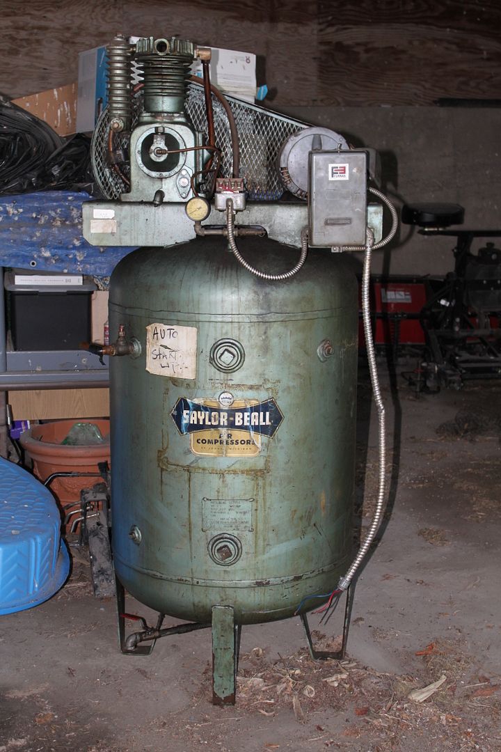

I found my new compressor while browsing craigslist last week and it sounded like a pretty good deal. The seller didn't know what the model was or how large the compressor or tank were. He just said it was VERY heavy. What I soon found out was an understatement.
So anyway, the compressor is a Saylor-Beall VT-735-120 complete with matching compressor head (matching serial numbers). The S-B 705 compressor head on it is rated for a continuous 17.3CFM @ 175psi!!
This thing is a MONSTER! It stands over 6 feet tall and weighs nearly 750lbs!!
The tank was manufactured in 1978 by Buckeye Boiler out of Dayton, Ohio. The ends of the tank are .212" thick and the sides are .25" with a MAWP of 200psi and a MAWT of 450F. I haven't determined the actual build date of the compressor yet. The compressor turns over very smooth, but I have not energized it yet.

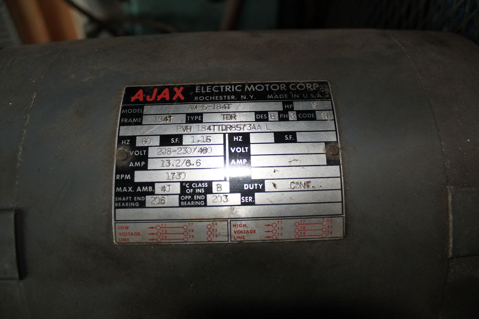

About the only down side:
Yep, 3 phase... I'm going to be stopping by the local surplus electrical supply store this week to see if I can get a static 1PH to 3PH drive or a 1PH 5HP motor (either 2 pole or 4 pole), but I think I'd rather get a drive.
