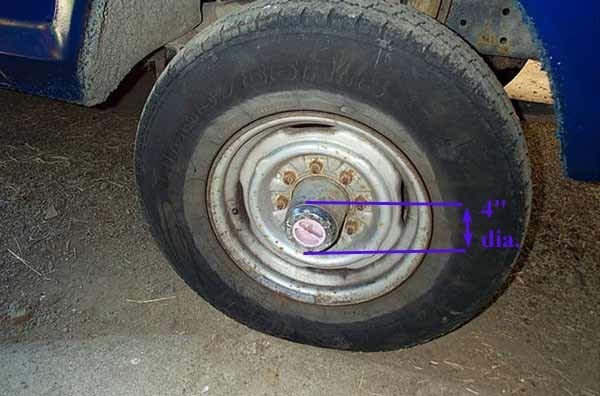

pretty sure the hub diameter of a dana 60 is 4"
but i could be wrong. The wheel opening should be plenty big.
Didn't even think about the back
[FONT=Arial, Helvetica, sans-serif]The easiest way to tell a D60 from a D44 is the diameter of the hub. Lug pattern alone is insufficient as there were 8 lug D44s.[/FONT]
[FONT=Arial, Helvetica, sans-serif]The lockout hub on a D60 is approx 4" in diameter[/FONT]

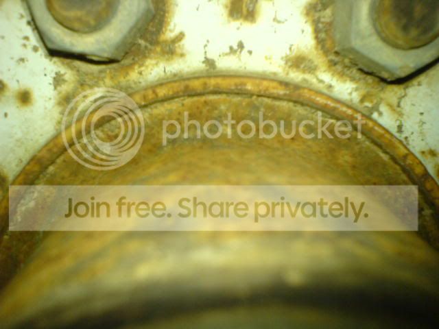

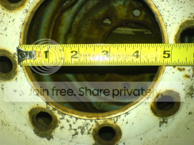

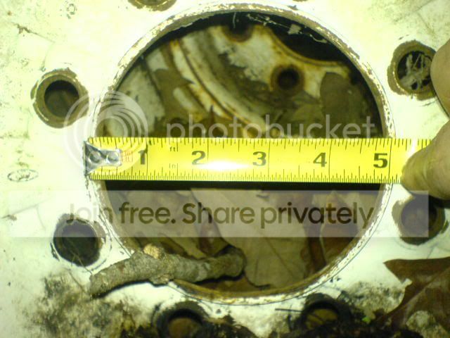

thanks guys, i did measure the center hole on my stock steel wheels, the gm rim was 4 7/8''...the fomoco rims were 5 1/16''....i wasnt sure if the 8 lugs for the 10b 8 lug would fit the d60...the gm 4 7/8'' fits the center hubs pretty snug and the fomoco wheel has @ 1/8'' gap around the hub, causeing all the load to be carried by the lugs since it doesnt fit center hub snug.
i see a red x??? if you dont erase the http:// 1st thats in the spot before pasting link it has 2 http and won't show pic...took me forever to figure that out... so the rims from a 3/4ton will fit a 60...
i see that 1...no radius indeed, so u think the radius diameter of the 3/4 ton is same as d60 hub w/o radius so they could use same rim on 3/4 & 1 ton, guess i about to order those from summit(2.5''bs), i'll only use them until 60% of tread left is gone...then i'm going 16 or 17'' dc-1 black w/ new tires!
