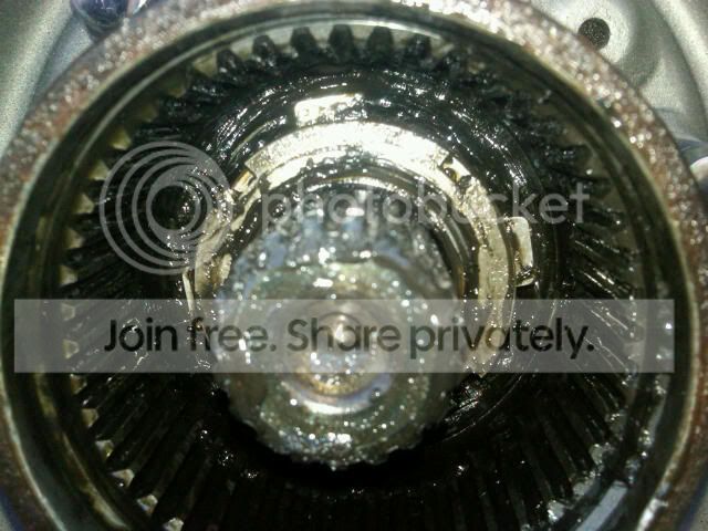

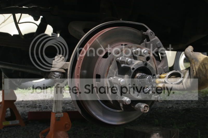

OK, so there are 2 axle nuts separated by a washer. In the picture below you see that I am holding the outer axle nut. I'm calling it an axle nut, but it's probably a hub nut or some other name. Anyway, here it is.
You can see inside the hub that there is a ring with many little holes in it. That's a washer sort of thing that has a tab that slides into the spindle surface, and one of those lucky holes will fit over the nub on the interior axle nut.

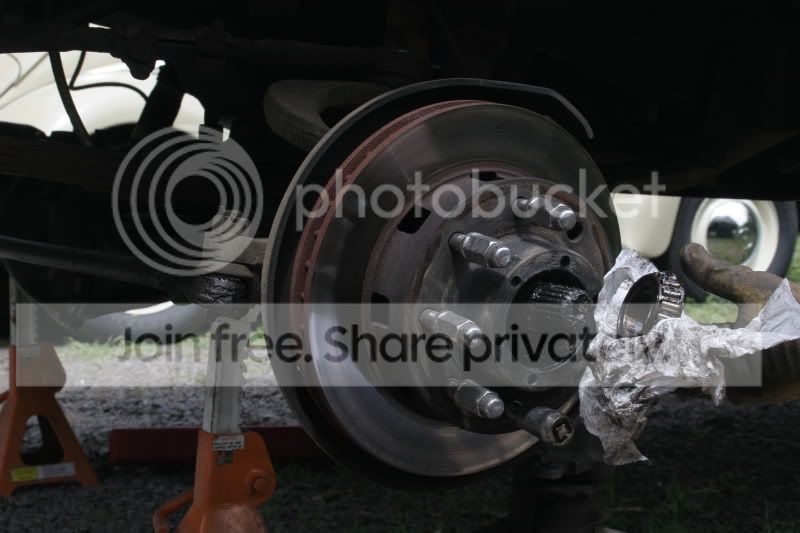

Once you remove the 2 nuts and the washer, the cone bearing thingy can come out. I usually remove it by pulling the rotor outwards a ways (of course, you have to remove the caliper to do this.) Here's a pic, I'm holding the bearing dealio in a paper towel.
The purpose of the inner nut is to set the bearing in place and hold it there. The washer acts as a safety, not allowing the nut to move in or out once it's set, and the outter nut holds that washer in place as a lock nut.
To go through the process that you did for the outer nut doesn't really do anything, and the torque you set it to is incorrect.
It's pretty important that you get back in there and torque that sucker down to the right amount.
