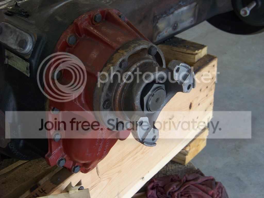

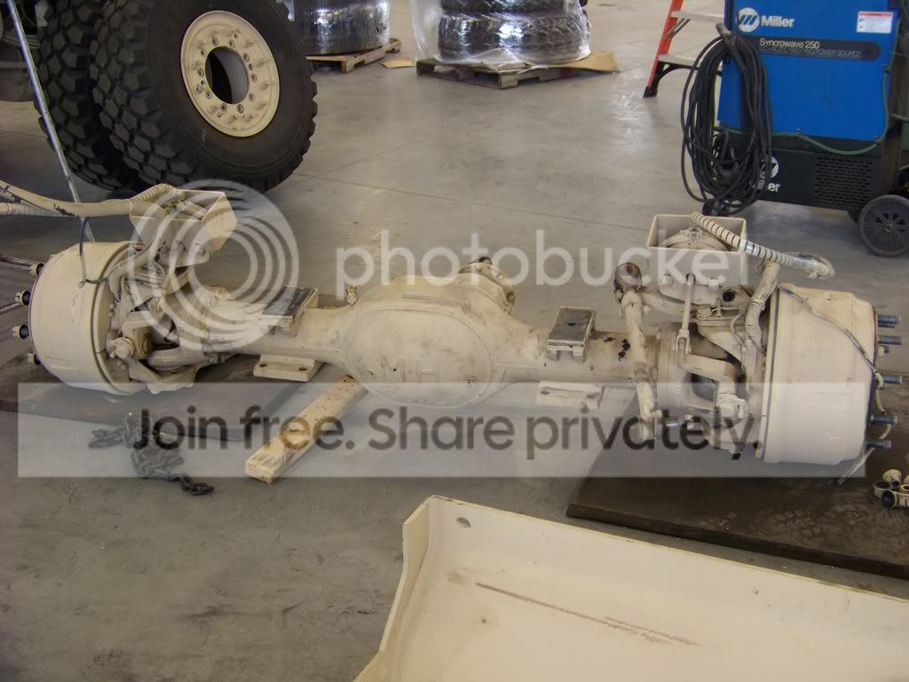

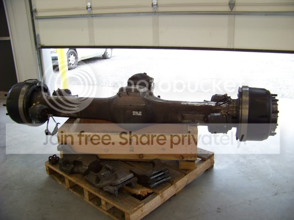

the old axles (werent bomb proof)

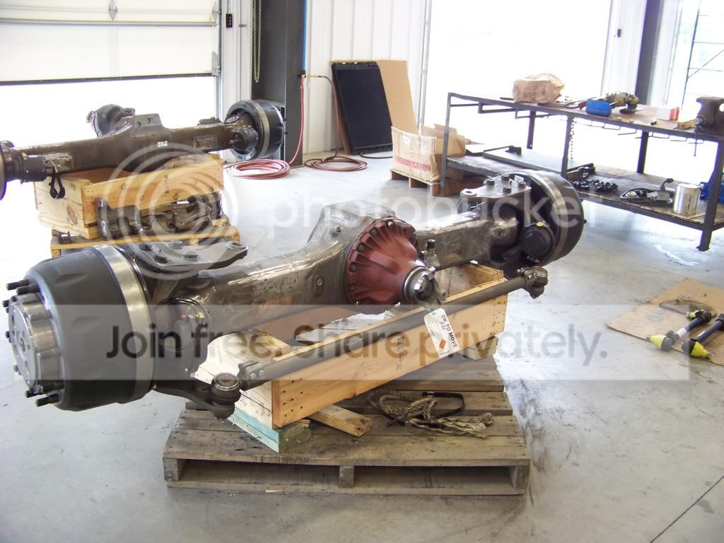

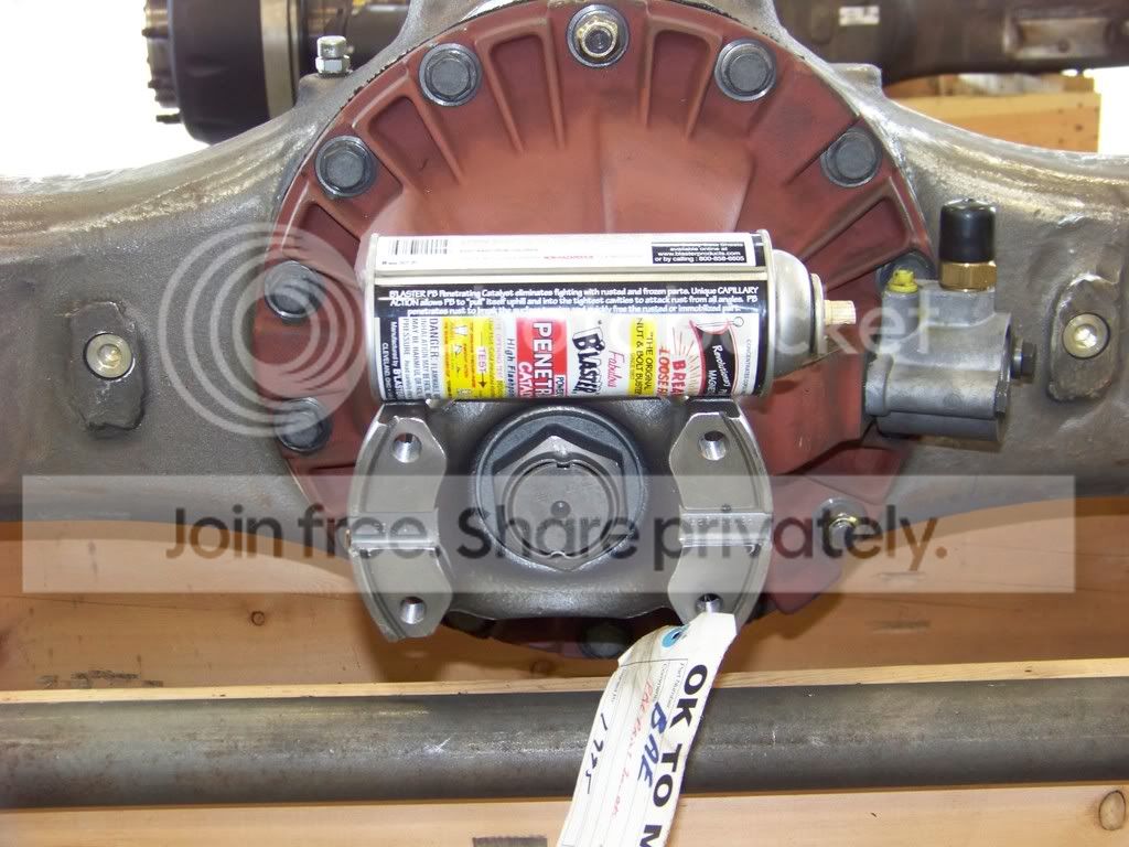

the new axles

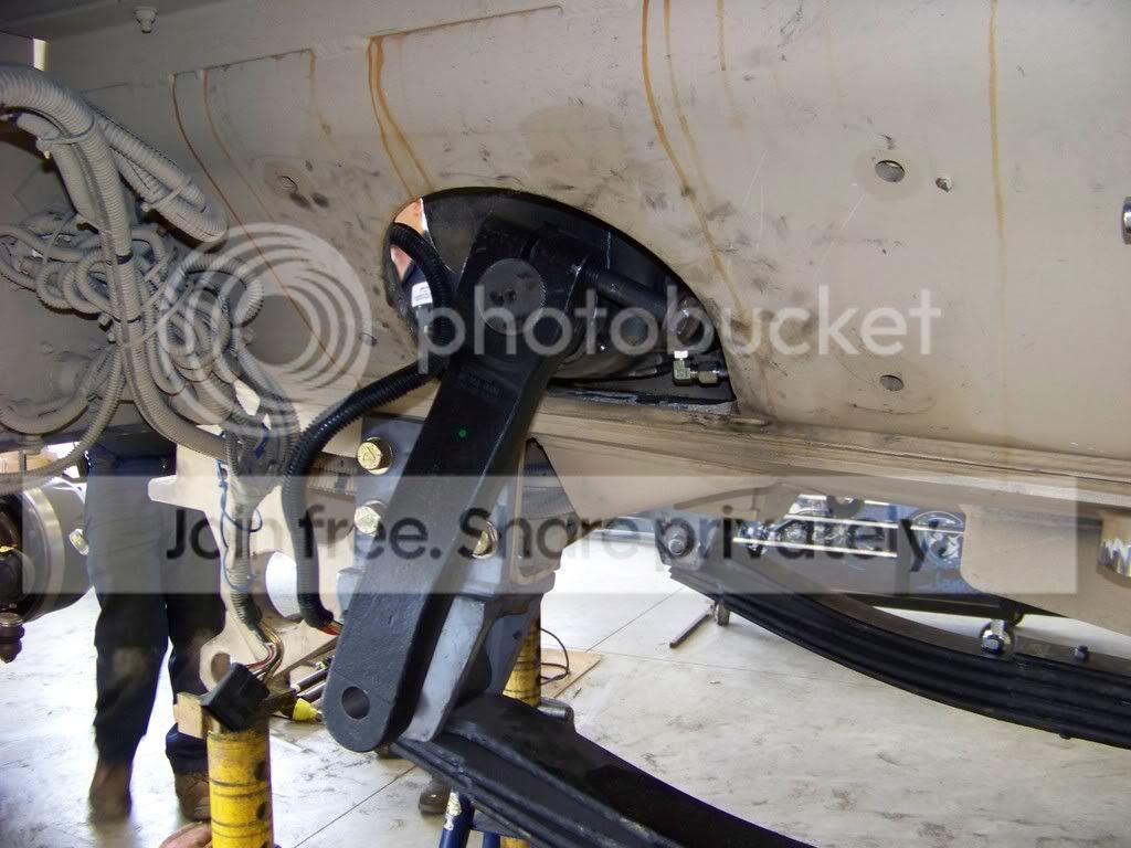

hi pin rear
Oh yeah, Marman Harrington axles. Beefy.
Whats the story on the swap?

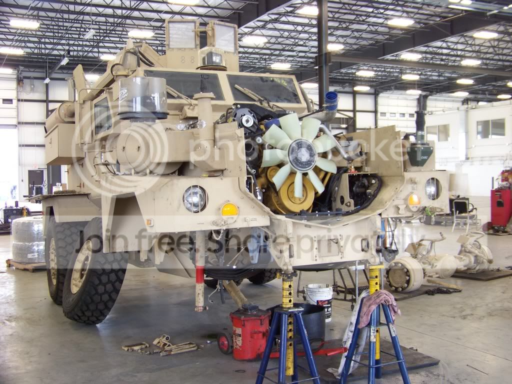

basically the enginers design theese trucks to be bomb proof...they have a turrett on top and a land mine setter on the front (neither in pics here) and they go out and make sure if they run over a land mine they will survive...well the tan axles broke like a tig so they are replacing them with the larger ones..also the spring hangers broke so they are making them out of 1 1/2 steel and the leaves have been increased...the reason there is 2 sttering arms i cause they are modifing theese trucks to run dual steering boxes...i have some more pics here ya go

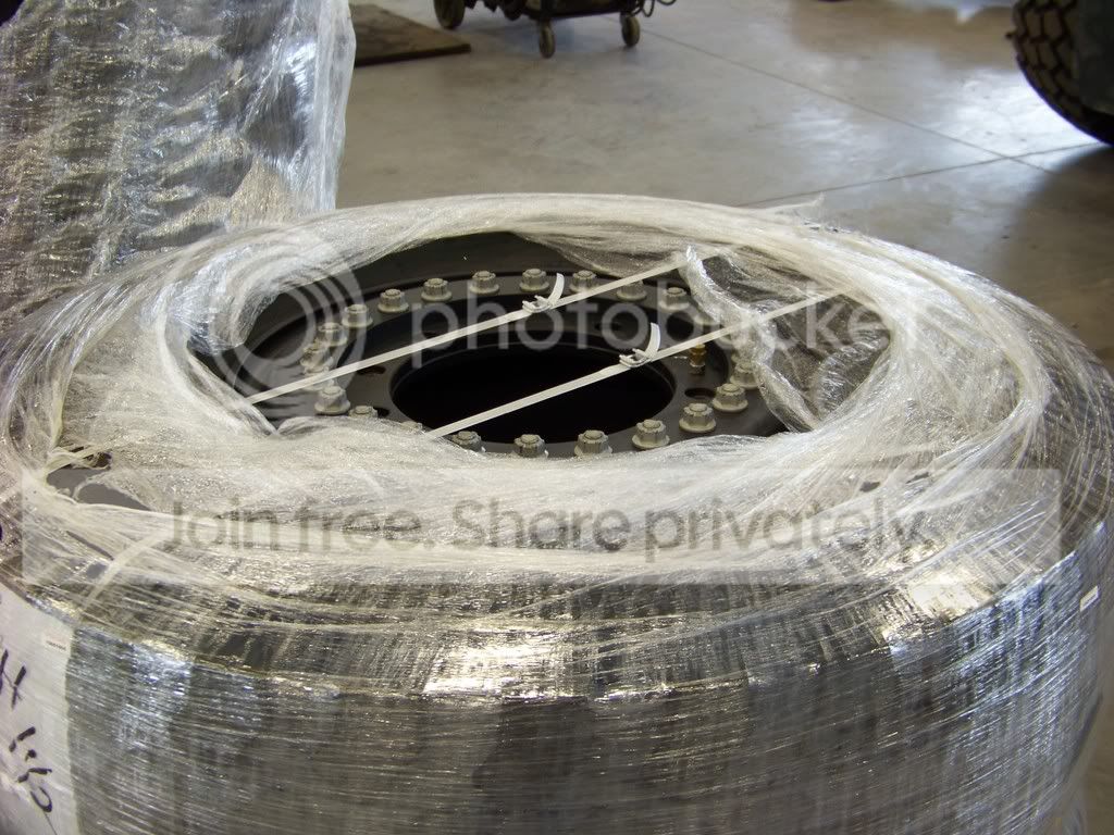

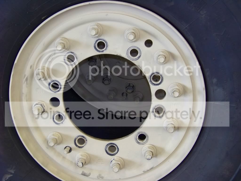

old wheels and tires
new wheels and tires

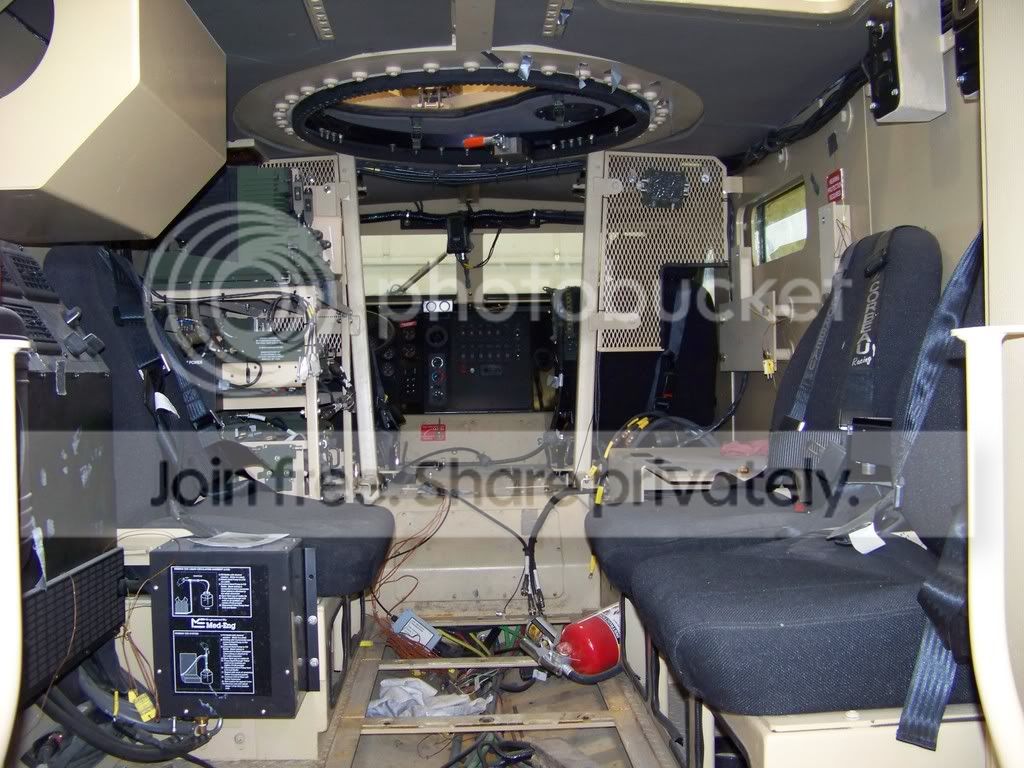

interior

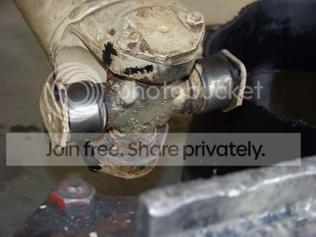

old u joints

Very cool. The jack stands look a bit precarious given the vehicle weight/mass though.

thats funny i stopped by the shop today and they have the whole front end back together and the front axle under it...its got huge 1 1/2 steel for spring plates unfortunatley i didnt have my camera...they started it while i was there after they put about 12 gallons of antifreeze/water mix in it
