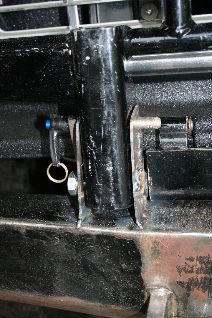

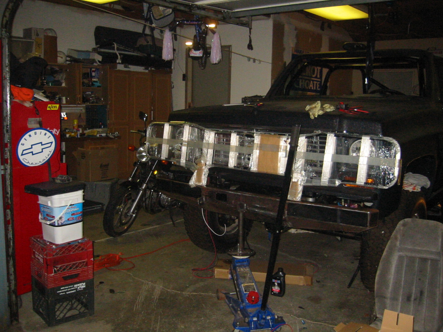

THis is the on ly pic I have so far, it's just setting up there in this pic. I just finished welding the brackets and have it folding up and down, my front clip is a fiberglass one piece tilt-forward, so the gaurd needs to move out of the way easily. I used the real Hummer quick pins.
I'm outta town, I'll have my wife snap a picture of it's current state.

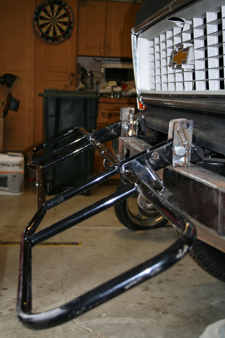

Here's some better pictures of the H1 Guard on my K5.
As you can see, it's wide. THe picture makes it look wider than it is, if you look down the body side, it's only about 1/2" wider than the widest point on the bodyside.
But like I said, if I can bend that around the side that would be perfect, short of that I'm gonna cut the ends and re-weld them so they are around the sides.
