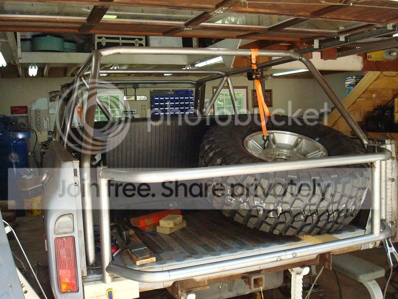

Here's a shot of the H2 with the 38" KM2. It's only an 8.5" wide wheel, and even though the tire is a 14.5" wide design, the look isn't too "bloated"....
