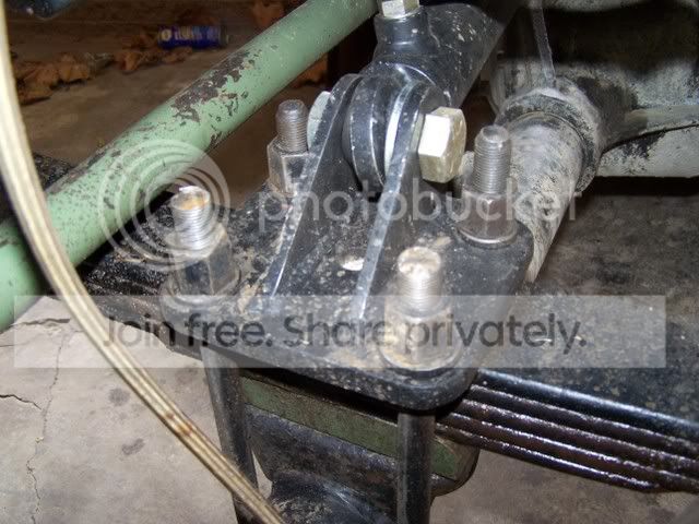

And 1ton, how is that mounted? Do you have a bigger pic? Looks like its on the spring plates from that pic.

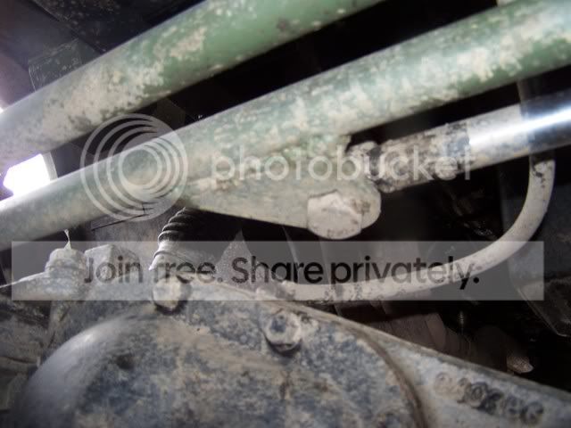

Heres all I have handy

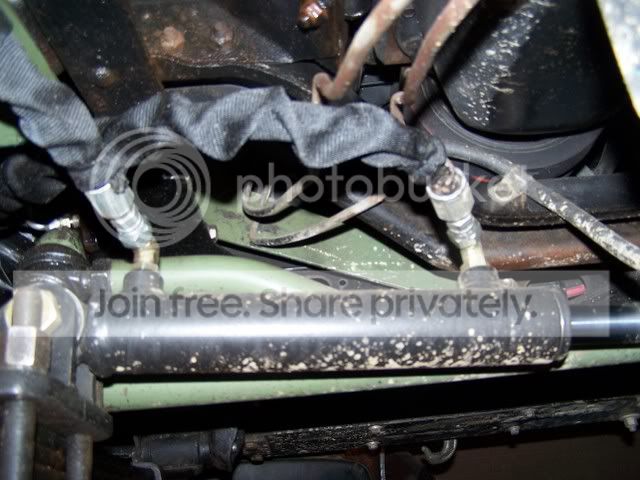

I personally like these cyl better than any Ive seen.If you bend the rod in one of these you've got other problems and the hym ends are made on.I have ran with guy's runnin PSC and others hydro assist kits and my homebrew works just as good as there's.

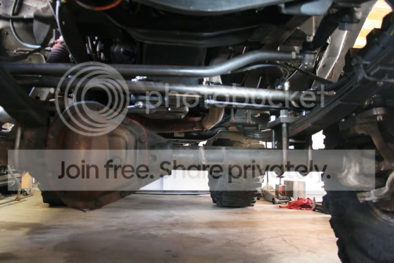

I just finished this this week. 2" ram from rockstomper, D60, 44" boggers. I dont think this is going to bend. No issues driving on the street.

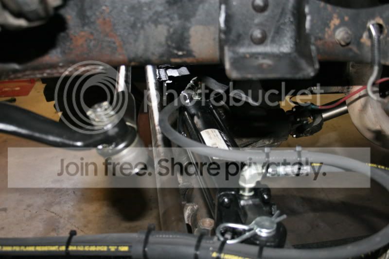

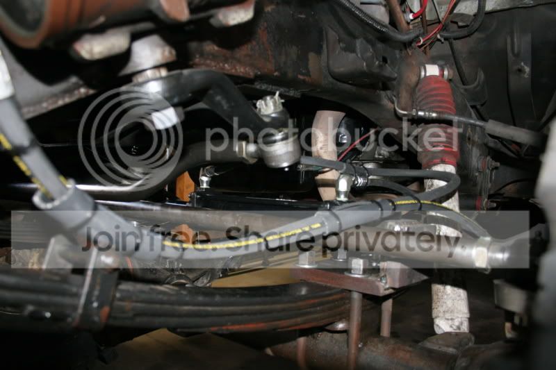

Updated pictures.
Updated pictures.

Chris, if that bent pic is from Andy's truck, then that is not a PSC ram. He used the old power assist setups from old fords, look at the shaft diameter.
