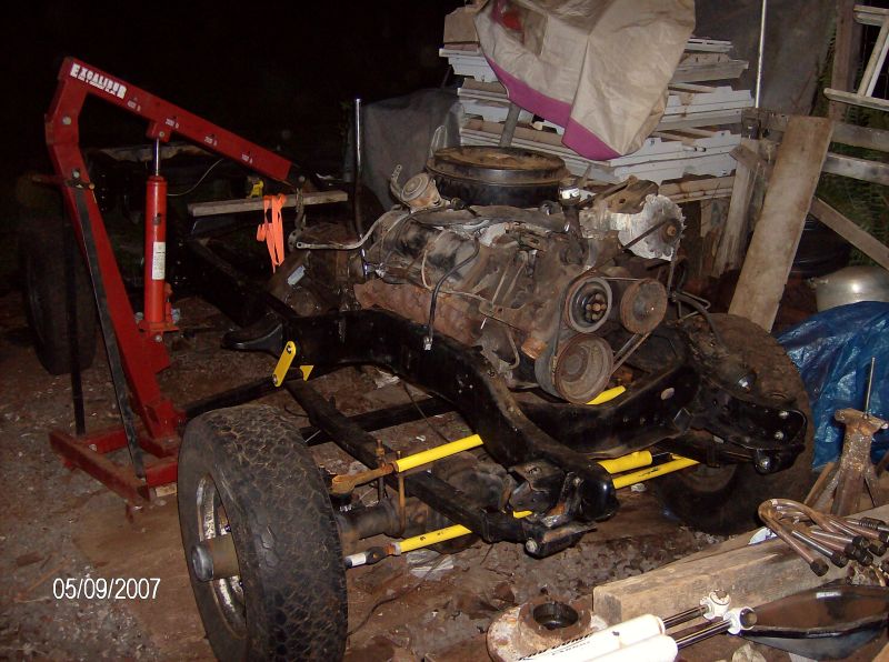

I used a tapped end cap replacement from JKW (I think, been a while), then drilled & tapped my own top cap. I had a local hydraulic house make up two 48" lines for me, and picked up a couple adapter fittings from there as well to make the lines work. I run a FSJ pitman arm on a 2wd box, and a Sky Manufacturing crossover arm. I got the ram from Surplus Center. In hindsight, I would have gotten the ram with the two orbital eye mounts instead of pin mounts. I have just realized I really don't have a good picture of the steering, this is about the clearest one I can find, and it's all just trial fitted.
