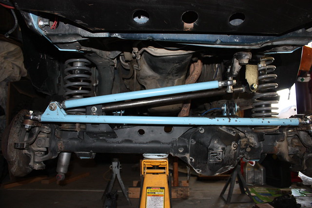

im running mine like that but in High steer with heims. Just like this. Just make sure you have a flex joint on one end, I'm running a TRE at the pitman arm
