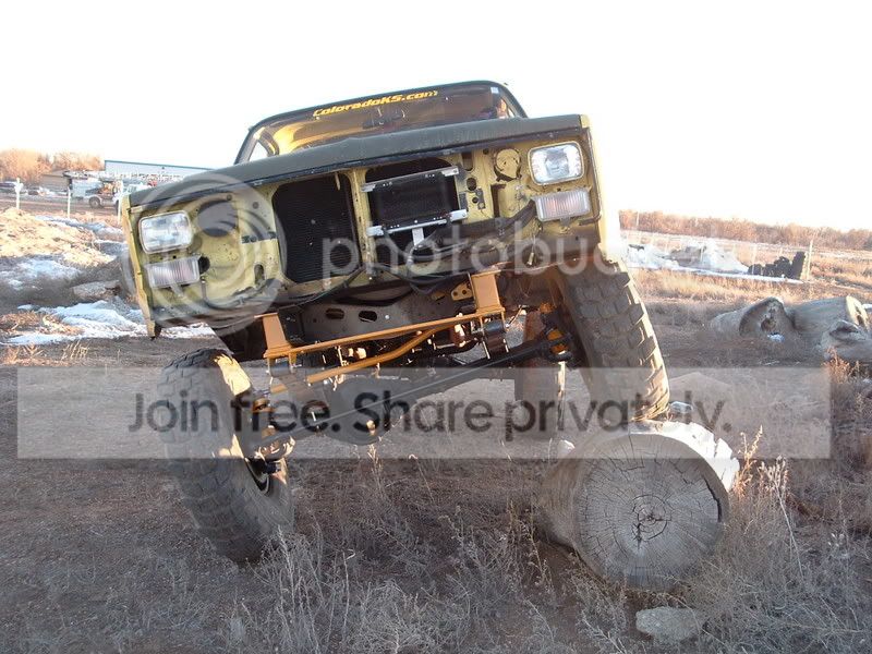

My truck wasn't originally equipped with one. I later installed a tube and fin style from a Caddy. You can see it mounted below the trans cooler here:
The cooler is on the steering gear box return. From what I understand it's not a good idea to restrict the hydroboost return. Plus when I flushed the system I found the hydroboost return only flows when you depress the brake pedal. Where as there's always flow in the gear box return line.
