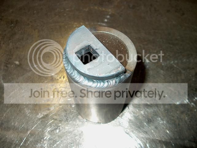

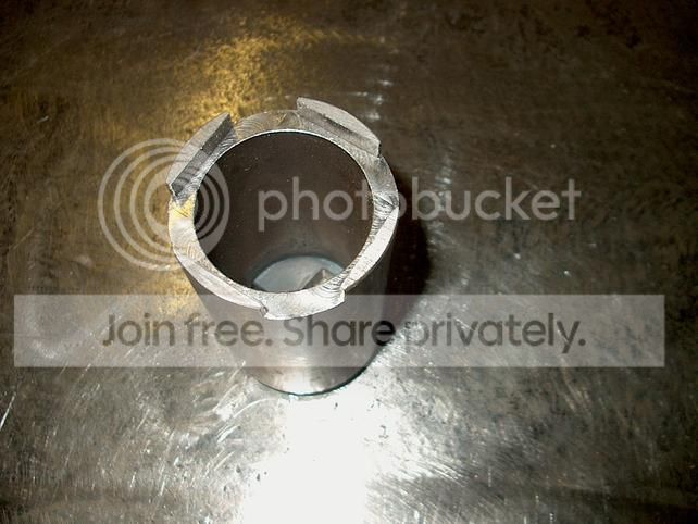

The link to the ebay tool gives me what I need to machine my own tool. He even lists all of the dimensions in the ad! My main concern with making my own socket was taking the rod off first to use it. But, that design looks good and doesn't require removing the rod.
I'm actually only an hour out of Seattle, so running to get stuff I need isn't too bad. But for a simple tool like this, I will make it myself if I can scrounge up the material easily.
Captainfab over on the '47-present forum makes all sorts of adapters to stick hydroboost in older trucks. One of the best things I think he makes is a tool to remove the nut.
http://67-72chevytrucks.com/vboard/showpost.php?p=3939420&postcount=10
