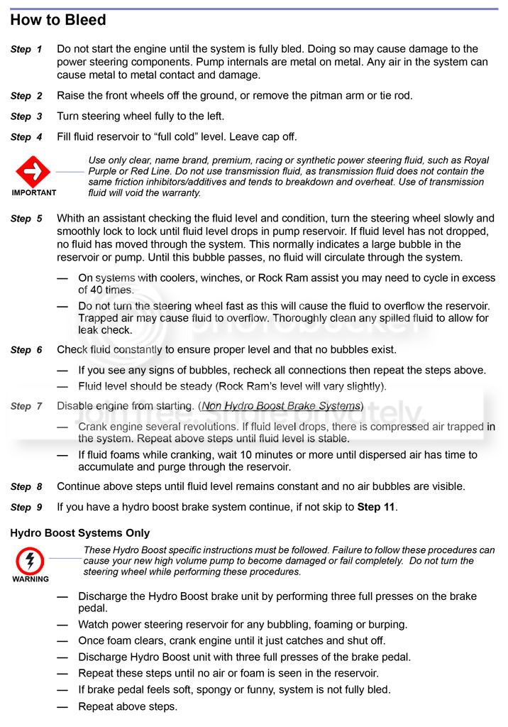

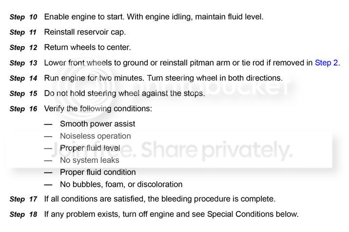

I always follow this procedure:
Sounds like you might have done something a bit different. May not help, but this procedure has always worked for me.
The main things I see that I did different are, not filling the reservoir with the steering at full left lock and I may have cycled the wheel too quickly. However, I have a stable fluid level now and did before I tried driving it.
I'll follow that bleeding guide tomorrow when I try a known good pump on there.
