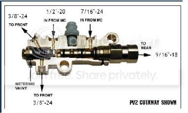

I think if you got the fronts, that the prop valve may be the culprit. Can you crack a line at the frame above the rear diff to see if you have any fluid flow there?

There is that little release pin on the side of the combo valve, but I think it's supposed to force pressure to the front even if the there is none to the rear. If the the fronts bleed, there is pressure to the front. If there was no pressure to the rear, the brake light should be on.
So there must be a problem with the rear plumbing or the wheel cylinders. If the wheel cylinders aren't new, I would suspect that the bleeders are plugged. Just start cracking lines to see how far back the fluid makes it.
