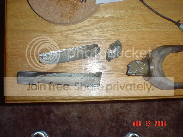

I took the blazer out today for the first time since august. The first trail I went on ate my lunch...I snapped an axle, blew out my power steering pump, and developed a nasty death wobble on the drive home. Took me 2 hours to drive 20 miles....

I was hammering down on the skinny pedal and I thought my locker wasn't working or a hub was busted. But it was a shaft...
From the picture it looks like you didn't explode the shaft causing damage to the spindle, just simply snapped the stub.

I would say it was a mixture of bad luck and my heavy foot:doah:

you must have been beating HARD if you broke it with those 37s
I did this on 37's and my rig was only 4500 lbs. at the time. The stock stuff shafts are made from really crappy metal (I've heard 1020 or worse) and they're by far the weakest part on a front D60.

The locker breaking when a shaft breaks seems to be random and in my opinion, you're better off with a better shaft that is less likely to break in the first place.
