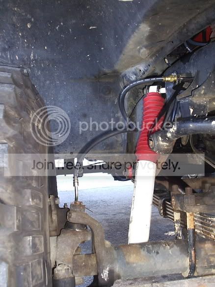

how long are they? pics?
25.5 inches, I put a twist in the hose so that it would stay farther away from the tires. see the pic below.

Did you bend the hard line up to get that much 'play'?
