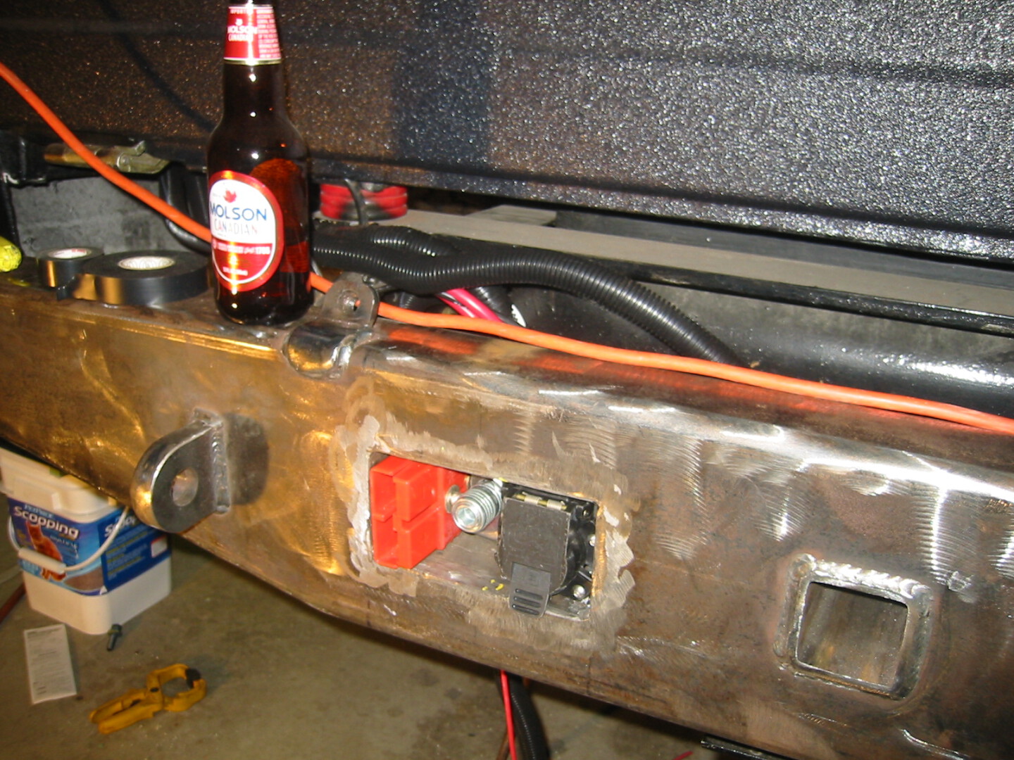

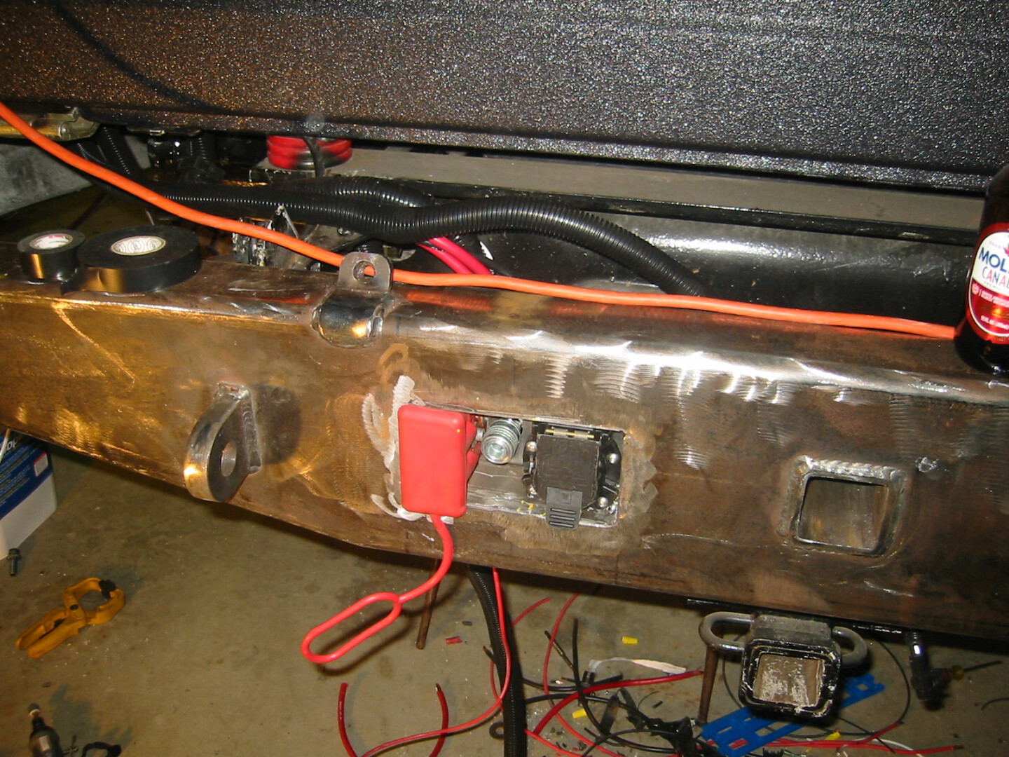

Winch connector (for Warn 9500 Multi Mount), Air, and 7 pin trailer connector in DIY4X's rear bumper.
Took me days to fab all the little brackets to hold that stuff in there.
I have main 2ga feeds to the winch connector and it branches out to feed my 2 stereo amps and 500w inverter. All that stuff terminates inside the 4/0 terminals in the winch connector there. Took a long time to get all that straight, clean and hooked up.
Too bad I have to cover it all up with a Spring loaded license plate holder.
I have the same thing going on up front, well, less the trailer connector.

I'm using my factory 1973 oil sumped A6 AC compressor with an oiler/de-oiler setup and I have a OTR truck expoxy lined 8 gallon air tank mounted under the floor. Using stainless 3/8" line front to back with a manifold and regulator for the ARB's.
