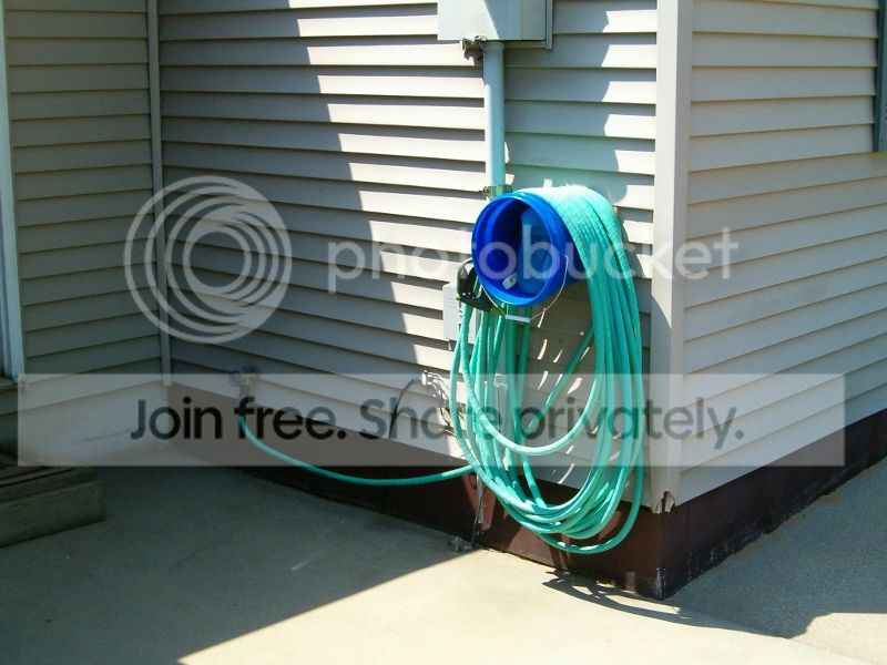

My little garage handyman has a thing where you take a 5 gallon bucket. Cut a piece of plywood to fit inside the bottom and use that to anchor thru the bucket into the wall. Gives you the bucket to wrap hose around so it's not too tight and kinked, and the inside to store nozzles and sprinklers. Plus should be easy and cheap.

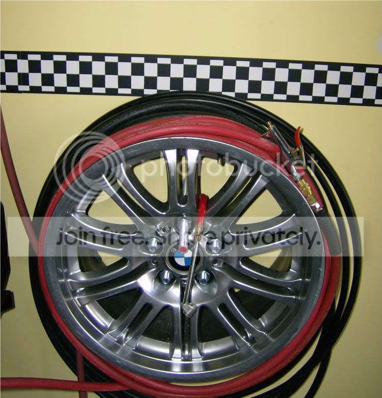

You could easily make one to look like a wheel and tire. Kinda go along with your hobbies anyway. Hell, mount it on a spindle/hub and get some swivel fittings so you can just grab the end and walk away.
Thinking something lightweight though. Small car spindle/hub and an aluminum wheel.

link? I think I know what your talking about, seen a galvanized pail setup like that...you think that could hold up to 100' of filled hose though? Also the plastic tends to get brittle in the winter, one bump into it, and I'm afraid it would break the bucket...this is what happened to my present hose rack...got bumped into in the winter and cracked the mounting pads.
How would you keep 100' of hose on a small rim? I can appreciate the thought though...I was going to discuss this more with you at the drags, after gathering some more ideas!!!! You got a plasma cutter right..:whistle:
Id venture to guess those buckets are way stronger than the hose reel, and would probably stay flexible in the winter.
You could always weld 2 rims together, but if it were me, i'd mount up a 17" truck wheel....

link added.
and as far as 100', that just depends on how tight you wrap it :thumb:

Not just a rim but a rim and something that looks like a tire but not necessarily a tire. Just something to make the rim have more capacity but keeping in theme. Think sidewalls.

cheap enough to try I think, do they make buckets like that in a shorter size, like a 3 gal? Just wonder about it sticking out from the house the 15-18" a 5 gal bucket is.
Pimpin' huh...so weld something to it for a hose retainer on each bead then?
I see a 17" wheel, mounted on a hub with bead locks that are 30" in diameter.
Like this idea too...Maybe I need to make atrip to the wrecking yard?
Yeah, you could weld something or if you went aluminum maybe some screws would be better.
Or 2 smaller rims joined with some rods that attach on the outer ends with lug nut. Could make it as big as you want then
went with this for now...quick and simple and just got a new bucket from Napa...
so it does work. i thought about doing it when i read it but wasnt sure. did you put plywood in the bucket bottom?
Yep Steve, had a piece of 1/2" laying around, cut that out and screwed through the bottom into the siding, making up a shelf to go above it to hold the dishsoap, and a few other items that dont fit in the bucket so good..
I really like this bucket though, plenty of room to wrap up a hose single layer.
