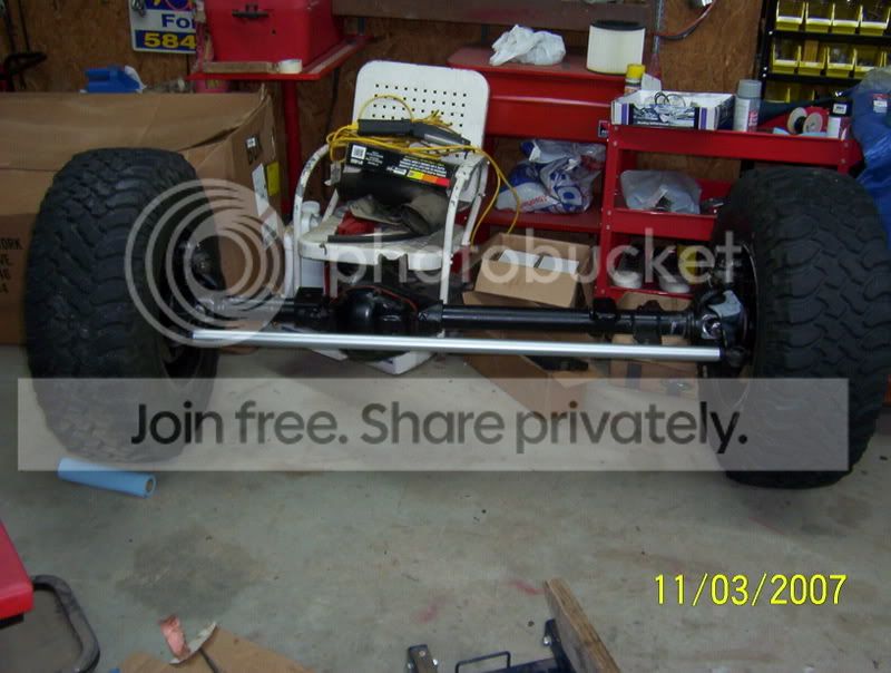

I got the same tie rod from ORD. It's BEEF! They also have a u-bolt kit to attach it. You can probably see it in my avatar.
EDIT, I guess not... here's the full size image.
