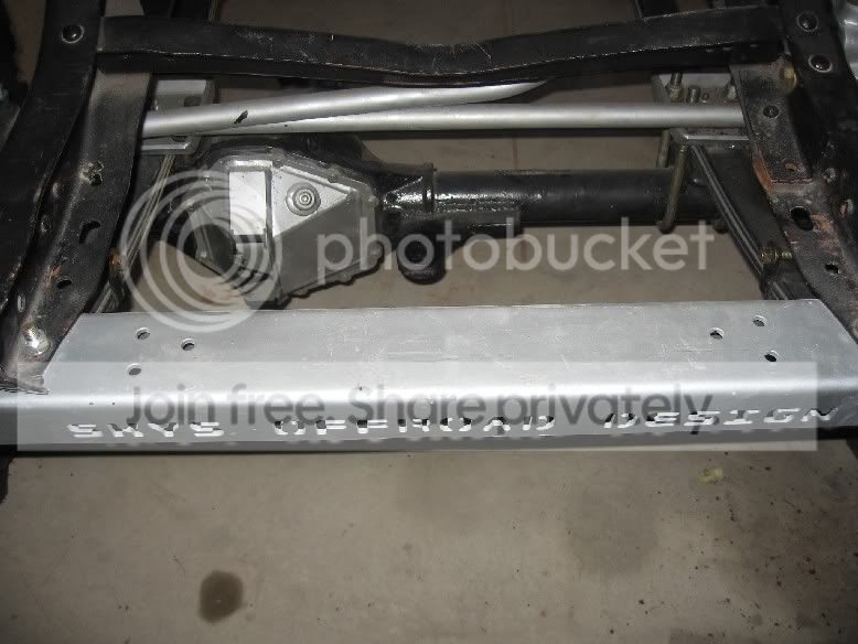

Hijack* Does sky still have that front crossmember for sale?*end hijack
