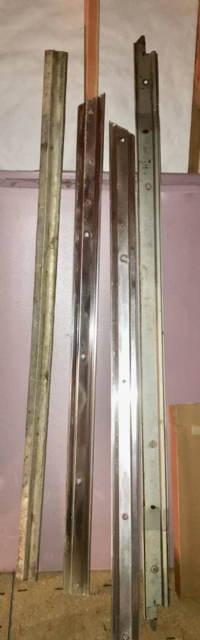

When I bought my project truck these pieces came with it.
Anyone know where the one on the right goes?
I'm not even sure it fits a Blazer
Been a while but I think that is a space filler. Bolts to the frame under the tailgate and under the bumper.
Middle pieces look to be brackets that go under each side of the hard top.
They sit on bedside then top goes on.
That’s where they go, except the hardtop gets sandwiched with them to disperse the load of the bolts. So it goes bedside, hardtop, then the chrome pieces.
And the piece on the left ‘might’ be the carpet trim that goes at the end of the bed at the tailgate. Hard to see on my phone.
Lol got me there I messed that up and own a K5.
They go inside on top on hard top then you tighten your bolts down.
Maybe I need to post a pic to remind myself
